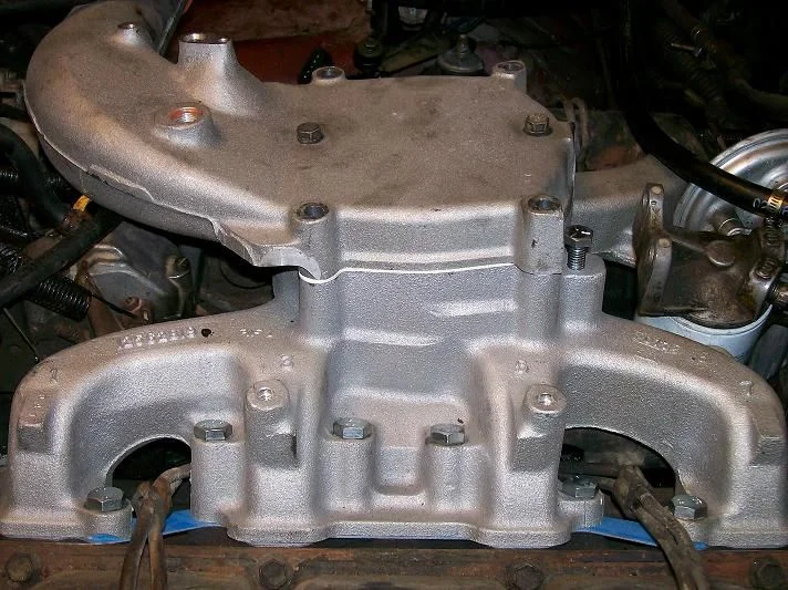

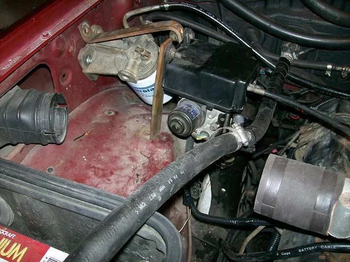

Well a couple of pic's for update. The turbo and manifold are back off because the I don't have room to mount the Speed control unit where it was originally at. The PO had placed it in the current location due to cable length. Well that won't work since a turbo now occupies that space so I will need to find a cable for the throttle and see if I can make this work. I hadn't had it mounted this whole time while I was playing with the turbo and now I realize it is in the way.
Also here is a pic of the nice new intake. I need buy some new clamps but for now I have been running it as is. Also making a bracket for the fuel filter on the rear of the manifold as the old bolt locations are no longer there.

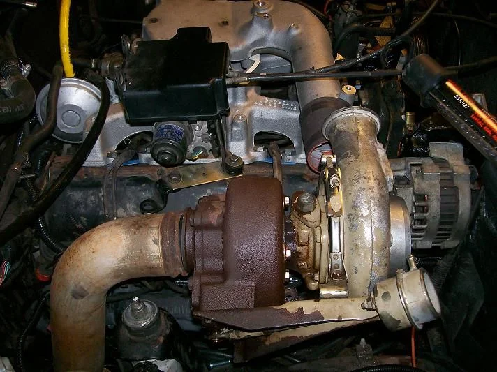

Sorry guys there was a problem with using the GM8 turbo. Since the down pipe turns at a 90 off the back it was right dead over the shock tower, So Diesel depot found a holset turbo that would bolt up to the GM flange. And it exits straight off the back end. Also attached is the adapter plate I had made for the maifold spacing to clear the injectors. Still mocking it in since I have to change up the initial set up but atleast I can work with this. Also need to change up the radiator ports and a couple other PITA items. But it is now nearing an end.

That is a lot of work, I wonder if the Banks kit would fit better. I had heard there was a problem with the shock tower but there is another member that has a 6.5 turbo in his 80 and I don' t recall him mentioning it being that much of a problem.

The banks kit uses the same exhaust manifold, so it needs the same spacer or injectors changed out for 6.5l injectors due to their size.
As for the turbo down pipe, i am not sure...

I think it would have all fit if the engine was 2-3 in. further back. I think the person who did the work did not want to move the transmission, so he started from there, when he should have moved the engine/tranny back 3"ish. We have problems with fan clearance as well which would be resolved if we moved back.
Too late now.
