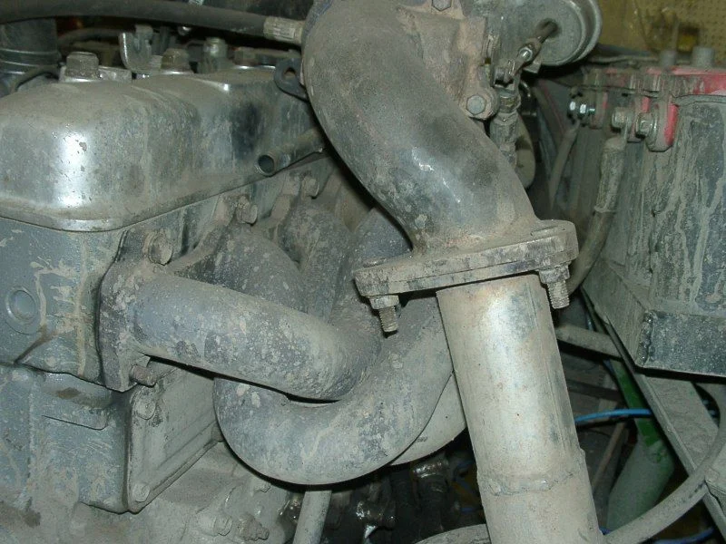

A bag of weld 90s, a t-3 from Lebaron and a bunch of porting will double your power.

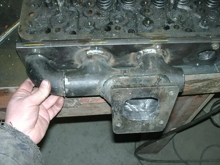

This is what you do if you have less weld 90s and a couple ts

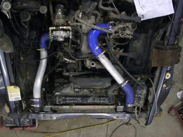

Add a Saab aftercooler and some ebay silicon and you're ready to burn rubber.

Hey Lowenbrau, are both those manifolds on a 3b, and does the equal length actually give you any extra? In the first foto (equal length) does the plumbing get in the way of the side plate I can see partially hidden behind it. Can you get at the lifters n pushrods behind the manifold. Not being critical, I recon it's great, just enquiring...
ps Do 3b and 13bt heads have the same exhaust manifold stud pattern. thnks

The equal length one is on a 3B that has a lot of porting/polishing done to the head including opening up the pre cups. The other one was briefly on a stock 13bt engine with the aftercooler before the rig was parted out. Its hard to say with any authority which engine made more power.
3b and 13bt manifold pattern is the same until mid 88 when the 3BII came out, then its the same as a 14B

Can you share with us what year and model Saab the intercooler is from? I'm considering intercooling the BJ60.

my friend is going to build me a manifold/header for mine he's got the big miller welder. he thinks it will be an easy fun manifold for him to build....
a straight up flip of the early 3b manifold is not practical for mounting and that setup is too high to fit under the hood(bj60).... and a hole in the hood is only cool if it's an off road beater and you have a tractor flap exhaust stack out the hood

Here's my setup stock flipped manifold and kkk14 turbo
Final result:
I'm planning to change my turbo by a bigger one, garrett T3 from volvo 740td
Cheers from France
