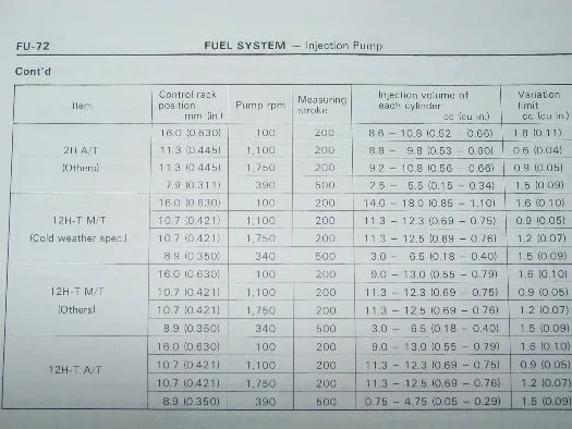

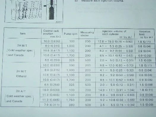

Here's another interesting point, I think: the over-fueling while starting. If you take a look at the different configurations of 2H and 12H-T engines, it quickly becomes apparent that with the auto trans installed, the injector pump is configured to deliver more fuel at a given rack setting, when compared to the manual transmission set up. So, when Toyota put the auto trans on the 2H, they chose the pneumatic governor-controlled injection pump. It seems that this set up facilitates and even greater fuel dump than the EDIC-controlled set-up.
If you scrutinize the charts below (taken from the Nov. 1985 FSM for 2H and 12H-T engines), you can see that at every injection rack setting the auto trans type of injector pump puts out more fuel than the manual transmission/EDIC system. Also, for the 12H-T, whether M/T or auto, the pneumatic governor is the choice of the factory.
