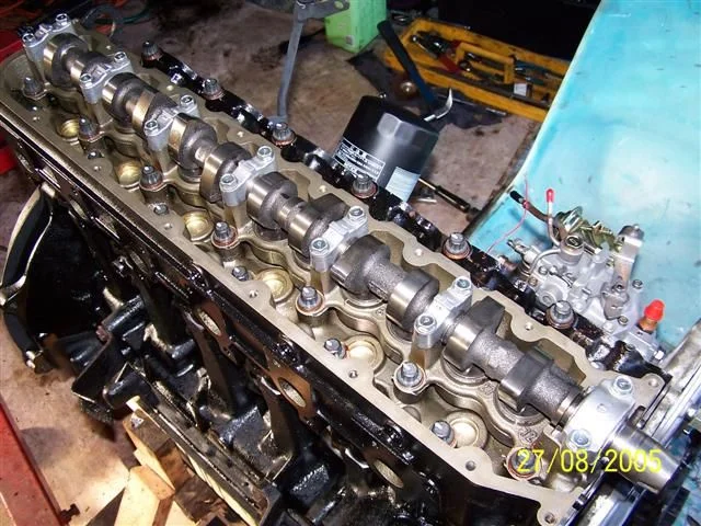

roscoFJ73's Avatar
Join Date: Jul 2003
Location: west australia
Posts: 5,956
Quote:
Originally Posted by 83bj60 View Post
Thanks a million! I'll look into it...
I wonder if that job can be done with valves held in place with compressed air through the glowplug hole... (I'd rather not remove the head like it's been suggested)
Gotta go for now...
I was wondering that too ,but with the OHC in the way,I dunno....... 1HZ below

Diesel for blood
roscoFJ73's Avatar
Join Date: Jul 2003
Posts: 5,956
Quote:
Originally Posted by canucksafari View Post
Now that's gonna get Brown Bear drooling. LOL
Its done 22000klm since the rebuild and it is fast for a 1HZ. Its never used a drop of oil or coolant since the day I 1st started it up.
The reason Ive never bother with turbo/supercharging is that its fine as it is. It had a full and costly pump rebuild as well. That really faWked the budget
Thinking I may swap it into the 75 and sell the 73.
I think this is the valve guide bushing with the seal above it .
Gotta go for now...
Can be done with the head on and compressed air,unfortunatly not a quick job, you will have to remove the cam,lifter and springs to get to the seals,make sure the piston is at TDC in case you lose air so the valve does not drop into the cylinder.

Yes yes, its an old thread, but thought i would post incase it gives someone piece of mind........
Notice a common theme????
The Grey cruiser has 300,000+k's on the clock and the maroon cruiser has done 120,000k's.
Thats running slowly in low range. They all do it regardless of age and condition. Its injection related.
Mine is the Maroon cruiser, and it is currently in the shop getting the injectors overhauled. I am getting them set to a higher burst pressure and having the pump timing advanced. That should complement the adjustments i am going to make to off boost fuel compensator. (adjustments that get the turbo boosting at 1000rpm rather than the factory spec 2500rpm )
I have a tech article on how to make the adjustments if anyone is interested, where do i post it??

Quote:
Open a new thread in the diesel section and let us know ..
On a side note .. the factory 1HD-T settings, place your turbo CT26 running at full boost @ 2000 rpm ..

I have said over and over, if you are unsure if the smoke is fuel or engine oil, take a good smell of your tail pipe. If it smells like burnt motor oil (blue), it could be your turbo, valve guide seals or your oil rings. If it smells like diesel (black or white), then usually it is your fuel filter, air filter, injectors or injector pump. Also, make sure your valves are properly adjusted - something I need to do soon myself.
Doesnt tally with my observations. Every text book I have seen says oil burn as blue smoke and injection problems as black smoke.
Low range ,high rpms with little load on the engine as in th
