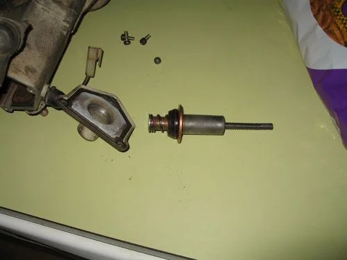

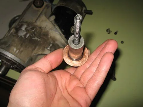

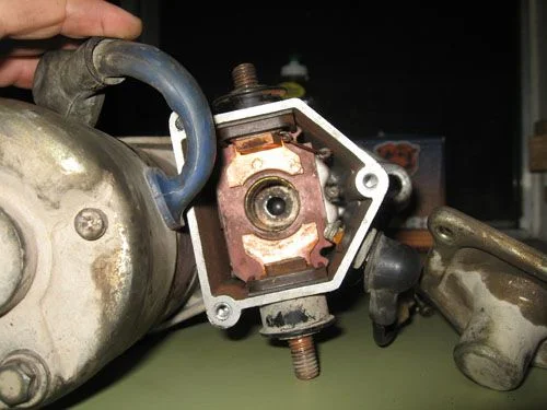

I got it open, it didn't seem to be welded in place, im confused!
WHat do you think?

Before you put the starter together you may want to change or clean the contactors anyways. The top one looks like it has some crap on it. Usually it'll be a little ball of copper.

Quote:
Done done. The long center spring had some crud on it that looked like old grease, so I cleaned it and gave it a new light coat of high temp grease.
There weren't any burrs or raised areas on the contacts, so I'm not worried, but I used a drill to spin the plunger against the contacts to sorta wear them all together. Worked great.
