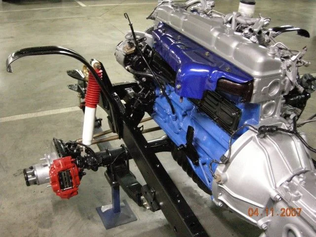

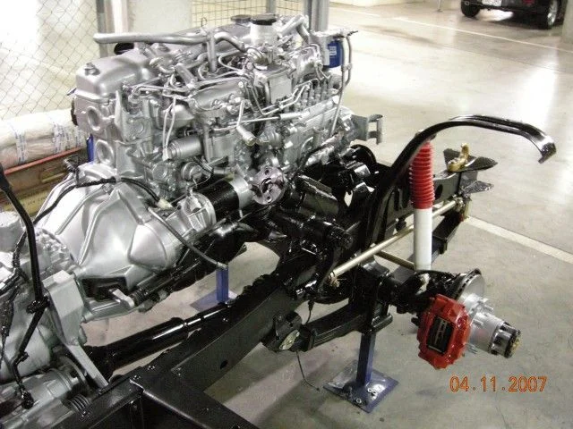

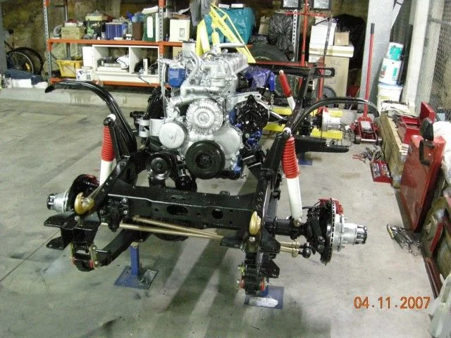

I recently made the exact swap you are contemplating. ('86 HJ60 auto with 2H to '83 FJ60 with 4 speed) Currently the entire swap is photo and word documented on my business blog: Adventure Motors Costa Rica
Resizing all the photos I took for posting on the forum is a pain in the a$$. I wish the forum site would give us an automatic routine...
I used Specter Off Road for the conversion parts. I have PN#s and prices for your budget analysis... Can't say enough about Marv and company, they really take care of their clients and are interested in growing their business in the area of diesel conversions.
Best wishes to you and your Toyota enjoyment on this Christmas day. I'll be following your thread and I'll be available to you here on the forum.

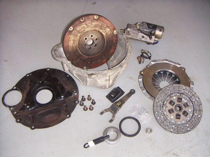

This is how we installed a 12HT into a 1986 FJ60; cut off original 2F motor mount brackets from the frame, ground smooth and primed/painted. Put Diesel motor mounts on the 12HT with frame brackets attached and set onto rear (transmission) mount while suspending the front of engine from hoist. Then installed radiator. We then positioned the front of engine to center on the radiator and tack welded the brackets to the frame. Disconnected new motor mounts from frame brackets. Next took the engine back out and finished welding the motor mount brackets, ground smooth the welds, primed/painted. Next reinstalled the engine, now properly positioned.
Our new motor mounts, 2 for the engine and 1 for the rear at the transmission, along with frame brackets, were supplied by G & S Cruisers in B.C. when we purchased the 12HT / 5 spd transmission.
I hope this helps for guidance - it worked fine on my install.

Moondag,
This is what your 2H will look like in a FJ40 chassis.
Make sure you mount it in the right place, to far back it will hit your firewall, to far forward and front grill won't meet your gaurds.
IF you need any info on the install give me a PM.
