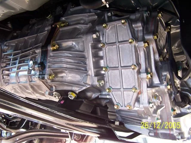

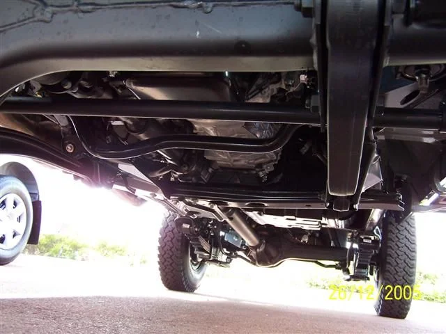

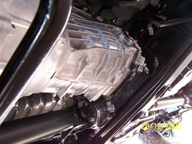

I was looking at these pics I have of a H151 behind a 1HD FTE in a 05 troopy.
The closeness of the output flanges to the gearbox casing make the t/case look compact compared to my memory of a H55f and t/case.

Thanks mucho Rosco, thats exactly what I needed to see, very clean.
Looks like it will fit.
