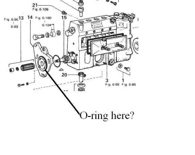

I think RacerX is saying there is an O-ring somewhere here?
But this picture is of the injector pump on a B engine and I think many of the parts on a 3B injector pump may be "mirror-image" because I think their pump is on the other side of the motor.

If so ---- Toyota lists a "gasket here" (doesn't say if it is an O-ring or not) for both a B and 3B engine as part number 90301-77001 (for BJ4* vehicles)
PS. This same part number is listed as applying to a 3B-engined BJ60 in this part of the world.

Refer to FU- 27 in FSM B,3B,11B,13B,13B-T manual - manual shows O Ring exactly where LostMarbels indicates on the schematic included - i now see the o ring I received from toyota is the O ring behind this mounting plate - and the 3B is inline pump - external oil supply , lubrication. I can scan a foto in if y'all do not have the FSM downloaded already - LostMarbels: Cheers ya for the schematic - I would not have known of this other o ring - now I see I have some more work to do before buttoning up - where the i p mounts to timing case I have a good deal of leak /gunge - figured it was the i p seal
- First major work I have had to do to this truck in 7 years besides dynamo and leaking fuel tank
