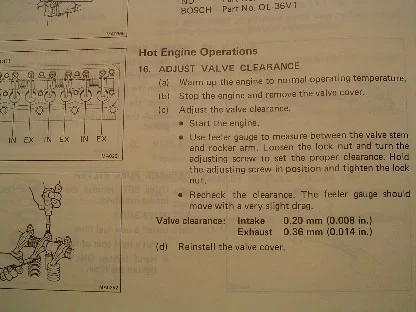

I think I'd pull the valve cover, check the clearances and put a drop of prelube on each rocker. Then do as Rosco said and crank it w/o the glowplugs.

Ya, could do but many 3B's are in need of a good valve adjustment and it's soooo easy to do. Also prevents rocker assy wear and the associated clatter. I always check a new-to-me 3B first thing.

I thought the valve adjustment was supposed to be done with the engine at temp(hot) not cold.........
Yes, most people recommend to do it after a good run and adjusted while it is still too hot to touch. Apparently shops rarely get them hot enough to do them properly (time is money). I paid to have mine done about 40,000 kms ago and it is due again. May give it a try if I can convince someone who has done it to supervise for beers. Greg? But for now, I think it is best to do all the other prep and leave the valves until she has run for a few days without issues.

when dooing my vale adjustments i ru my 3b on highway (the 410) for 20 min thne pull head cover set to 14degrees (timing settings) and adujust the valves but ive found that to do this properly the engine has to behot not warm (i take the valve cover off hot wearing gloves) other wise it doesnt work as well(less hoarse power/shitty power) my 2 cents take it or leave it

I know the F engines require a hot adjustment ,but does the B manual say the same thing?

Posts: 329
Engine up to temperature
