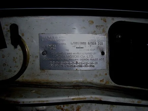

Here's the VIN tag. The VIN is HJ60-006227. Date of manufacture is June 1982. Steering pump is on the drivers side (RHD).

OK, I am going out for about a hour, so on the way back I will call into the Toyota dealer and get those part numbers.

Ok, here are the Australian Toyota part numbers:-
Top Hose 1657168010 RRP $26.15 AUD
Bottom Hose 1657268010 RRP $26.15 AUD
Small Hose 9955540090 RRP $ 9.67 AUD
Just to let you know if you have trouble buying them in the US, Roodogs4wd Spares a Ebay Store on Ebay Australia as well as some other Ebay store owners have them for sale for around the same price. They have Paypal as well as visa card facilities and do international mail. I have bought a fair bit stuff of Roodogs4wd and have spoken to him personally, never had any problems.
Hope these part numbers work for you, the dealer told me that all HJ60 that had 2H motors use these part numbers, they change only when you have the 2H in a HJ75 series.
