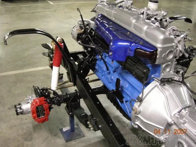

It sits on the side of bellhousing, here is a photo of my 2H install showing the sensor,

Quote:
Originally Posted by watrob View Post
hks3sgte is offline   Reply With Quote

Quote:
Originally Posted by Ducks View Post
Dito dude .. no clues what a nice 2H .. ! ( I thought best ever )
