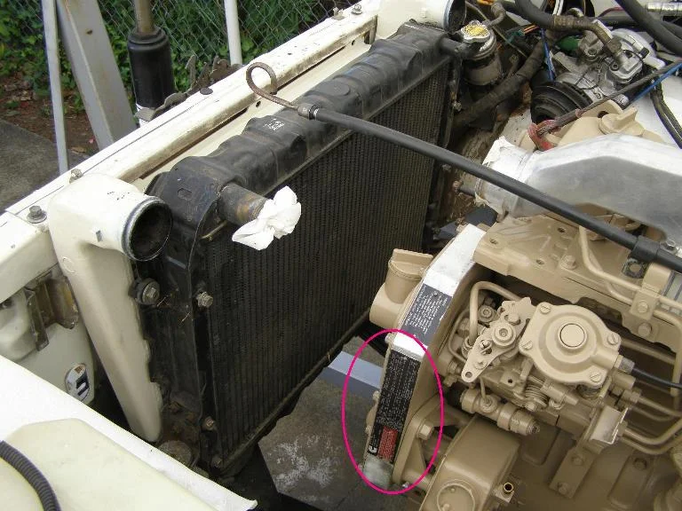

Yes, intercooled versions are 120hp factory and non-intercooled versions are 105hp. This info is also listed on the ID plate circled in the pic.
