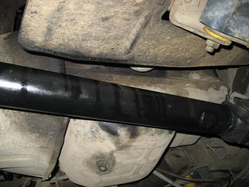

Yesterday i cleaned the drive shaft with degreaser, this afternoon i went for a 15-20km drive. You can cleary see on the drive shaft the oil drop, my guess is that they drop when i was going different speed therefore with wind the fell on the DS at different places.
My driveshaft was also wet but nothing like that.

Engine has 170000km...tired?...mmm..
I may need to return this pre turbo in the air intake.
