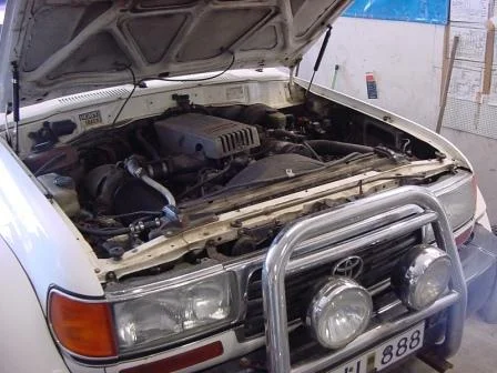

6.5 td
I stuffed a 6.5L TD-4L80 in my 80-1-HDT in 2005 from a Suburban 2500 97.

Don't mean to hijack the thread. But, tell us about it. Performance, efficiency, reliable. Would you do it again?

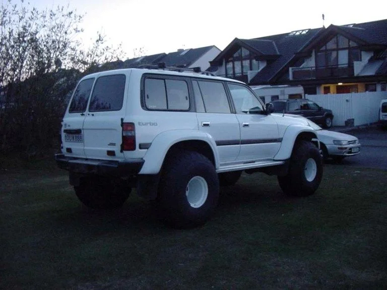

pic
I dont have many pictures but here is one.

Wowo looks cool. How did it run for ya?

Must be kinda hard parking that at the mall, not real practical here but I would love to have it anyway! That must be alot of fun taking those out on the ice. What gearing and suspension is on that?

Do you guys in Iceland make you own fender flares or is there a company over there that manufactures them? They look like the stock ones on steroids.

rtarh2o, if your cruiser is not suspension lifted you will have some trouble fitting the 6.5 td. The orginal turbomanifold interfears with the shock tower on the frame. My yoda is (or was) lifted ca 18cm on suspension so I lowerd the shock tower to fit the engine. A 5cm body lift would have helped on fitting the Suburban radiator, I lowerd the front body mount to fit the very wide Chevy rad and used a 11 blade fan. A big rad is a must for this mod up here when driving in up to 1 meter deep powder fuel use can go up to 100 liters per 100 kilometers so that makes a lot of heat. But thats only in extreme conditions. I used 4.88 gears and all dealer imported cruisers here have lockers. If you turbo your engine keep the boost low 6-8psi max or you will have headgasket problems, and with big diesel engine power the inputshaft on a 700 trans snaps... Many moons ago the 6.2L was the most popular engine swap up here.
Ps. Now my 1HD-T will go in my #eep Grand Cherokee and i have got a 7.3 Power Stroke for my 78 chevy pu
