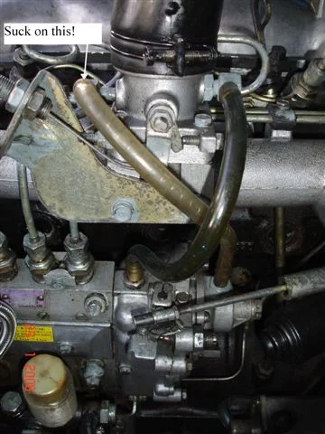

Originally Posted by lostmarbles View Post
And here's another photo that would be a good addition to this thread and my earlier reference to "sucking on a hose" to test your diaphragm:
Attachment 213419
I'm going to have to check but your hose are crossing each other, doesn't seem to be that way on my truck.

Quote:
Don't worry. I think the crossed-hoses could be unique to the B-engine.
I remember discovering previously that other people's hoses don't necessarily cross over each other (but their set-ups still work the same as mine).

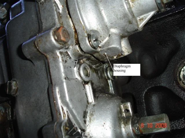

Quote:
Originally Posted by Tofudebeest View Post
I had no idle issues, nor black smoke (just the familair white/gray at start-up, virtually nothing once warm, but my IP gasket where the diaphragm is, is leaky. I was told to replace the diaphrams and gasket, but have not yet done so. Was I misled?
I seem to remember there is no separate gasket there and that the "diaphragm assembly" itself serves as the gasket. So if you want to stop the leak, then it could be wise to replace the diaphragm at the same time.
I guess it is difficult to tell whether it is "neatsfoot oil" or "engine oil" that is leaking out because both will be "black" from my experience. (Old neatsfoot oil turns black.)
My diaphragm housing used to have "dirty oil stains" around it at the joint but it is reasonably clean now:
When it was "oozing" - I don't recall any problems associated with it.
So my answer is - If you want to stop the leak - Yes - Change the diaphragm (and perhaps apply some sealant to ensure you get an oil-tight seal)
By the way - There is a drainplug there to drain engine oil (that leaks into there) from the compartment on the injector-pump side of the diaphragm (as I suppose you already know).

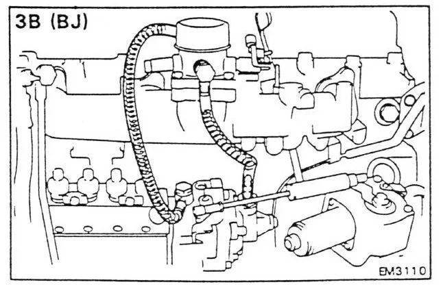

Attachment 213419
Lostmarbles, your hose are not installed correctly according to the manual.
Mine is a 2977cc B engine rather than a 3431cc 3B engine.
Looks like they moved the positions of the "venturi" and "reference" connections on your engine's intake manifold so your hoses don't need to cross over each other.
