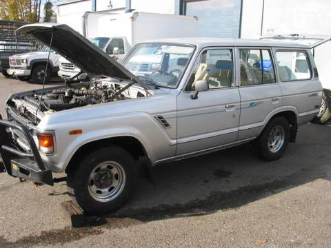

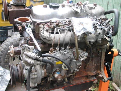

Heres the long story...
I picked up an FJ60 locally for my brother who lives near Chicago. The plan was to do some maint. and install an OME lift then drive it from Portland to Chicago - 2400 miles away. Its not easy to find a rust free cruiser of any model in that area.
Unfortunately (fortunately?) the more I dug into it the more problems I found with the engine. Ultimately I found bad compression on one cyl so I was faced with a rebuild.
I already had a 3B/5 speed that I was planning to put into a 60 of my own but I didnt want to part with it. Everything came together though when I found that crushers had a 1HZ/5 speed to part with. After a 3 day 1600 mile day trip to Calgary I now have a 4cyl available for my bro and a 1HZ for a future conversion of my own.
This is going to be an accelerated conversion. We WILL be driving this 60 accross the country on 11/17.
The 3B came from a converted FJ62 that someone here in Portland imported from Canada. The 62 was in really poor condition overall and the conversion was not done very well.

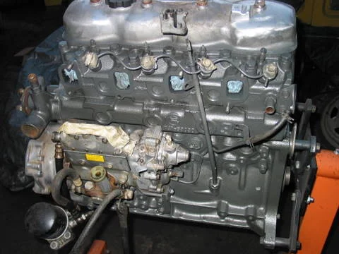

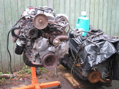

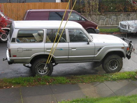

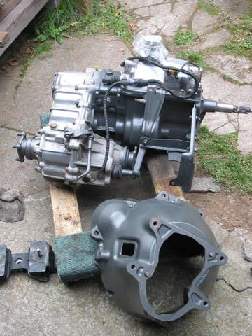

Here are some pics of the engine and the rig its going in.

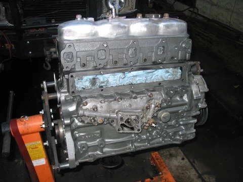

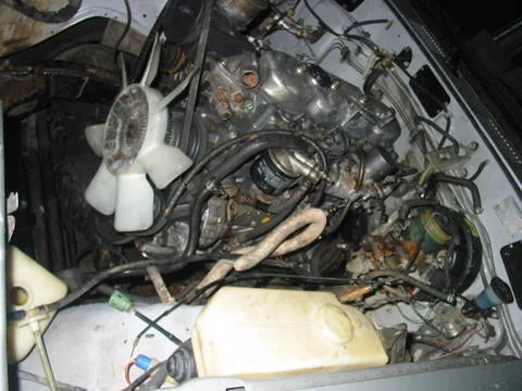

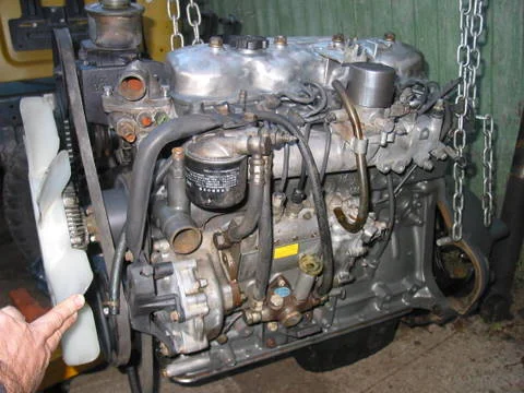

more pics - engine is painted. I put most of the parts back on the block tonight. I hope to have it test fitted for the motor mounts this weekend

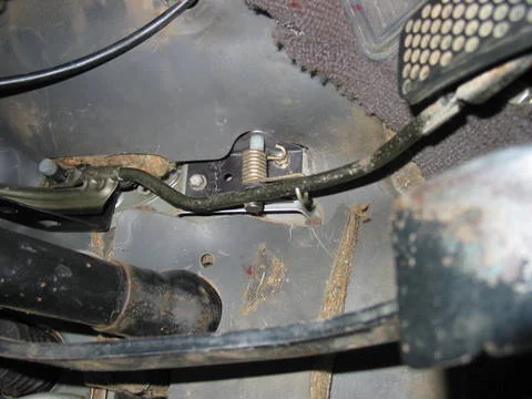

Waiting on a new oil pan. I have to move the clutch slave to the drivers side, configure the water and fuel connections and put the engine in permanantly - then it should be ready to start up. I hope to have it ready to run by next weekend. Rain permitting as I am doing all this in my driveway.

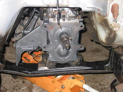

Im using the stock 87 FJ60 trans cross member which is set up to deal with the 10 degree tilt that was added to the trans some time in 85. I put a shim on the passenger side to level it out and it fits well.

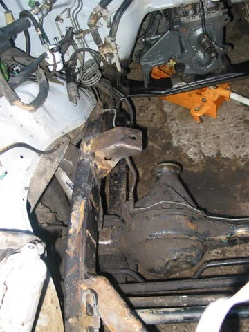

Progress from this weekend.

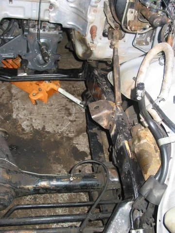

The BJ60 mounts welded to the frame. Nothing new here really. This 60 is really clean so Im not doing a resto like some others that have posted their conversions. Ill have to touch up some paint under hood, but nothing serious.

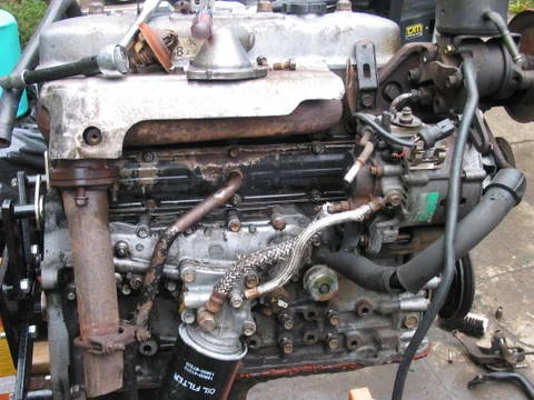

First one is a pic of the engine with some of the parts back on.
The second one shows the FJ60 trans cross member and the angle to account for the 10 degree rotation I mentioned before. Any FJ60 with the 3F bellhousing should have this rotation.
I added steel to the passenger side to rotate it back to neutral to match the 3B which has a straight output on the BH. The shims are just stuck in there for testing. Worked out to about 5/8 inch. The alternative was to make my own motor mounts to account for the rotation of the trans - I thought this was easier and I dont have any real issue with shifter alignment to the holes in the floor.

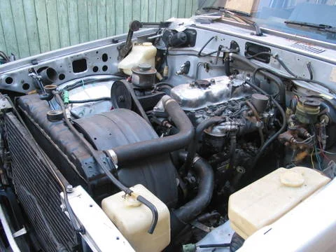

Engine is in!!!
I got a break in the rain this evening and I was able to get the engine in. Yes it does rain in the PNW....
Hopefully Ill get some dry time this weekend so I can connect the water and fuel lines and fire it up. I still have a lot of little things to do.

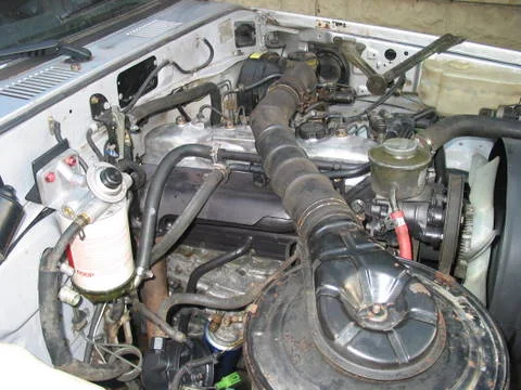

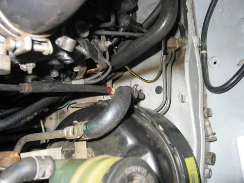

sorry for the lack of posts on this. I skipped taking pictures of the process of repainting some parts that needed it.
Here are some pics

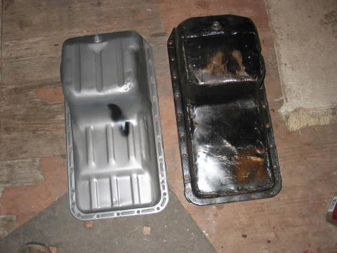

first one is the "new" oil pan.

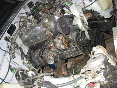

second two are the engine in and mostly complete.

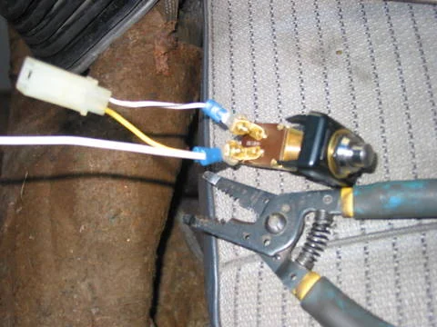

progress continued
I got a lot done this weekend.
Finished up these:
water lines
fuel lines
fuel filter
alternator wiring

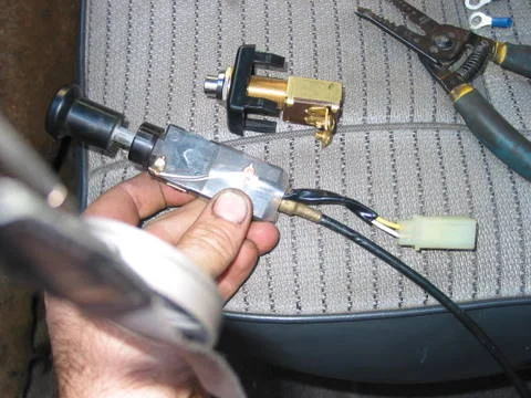

glow plug push button
accelerator pedal and cable install
adjustments to shift boots and floor panel.
I need to put the hood back on, wire the tach and wire the edic relay when I get it - then I need to install the OME lift and FJ62 axles - and exhaust and and and.... Hopefully this will all be done before next weekend.

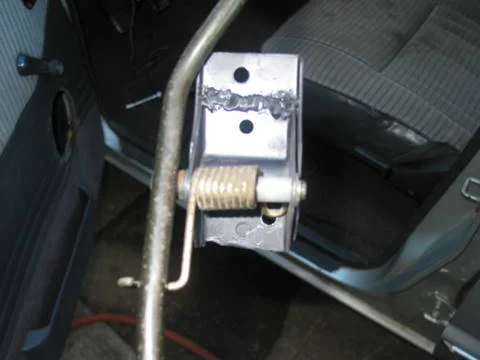

Pics of the pedal conversion. I used an FJ62 pedal and cable assembly. I have a BJ60 setup on the way, but I cant wait for it to get here. Also some pics of the glow plug button. I used a BJ60 relay and wired it in to the choke circuit. The choke light comes on when you press the button - I think others have done it this way.

pedal / cable
here is the pedal and cable.
To mount the pedal I used the mount from the 60 pedal as a base and welded the 62 pedal mount to it. The cable mounts through the firewall in a spot that was probably designed to fit the cable for a 3F. Just line it up and drill three holes. I was able to use the hand throttle from the 62 setup as well.

The 60 is mobile now. Ill be dropping it off for exhaust tomorrow.

Old 11-18-07, 07:55 PM   #22
Diesel Trucker
Join Date: Feb 2007
Location: Portland OR - USA
Posts: 951
Ive been driving the rig around town all week and put about 200 miles on it. My brother arrived here in Portland Thursday night and we have been working non stop to tie up loose ends
In the past few days we installed water, oil, and pyro guages permanently.
We also built a wire harness for the edic (between edic motor and edic relay). We spent a bit of time on this partly because I re-assembled the edic motor incorrectly. I had to take a working one apart to compare and got it working.
EGT has been a little high. Its easy to get to 1200 so we may turn it down a bit. There has been no smoke at all and oil pressure is great.
Last weekend I installed an OME lift and 33x12.5 tires with new rims. At this time I replaced the front axle with one from an FJ62 and replaced the rear diff with 4.11 from the same 62.
Tomorrow we leave for the 2400 mile trip from Oregon to Indiana.
Here is a pic with some temporary 32" tires on it. Ill post some pics of other parts of the process after the 25th.

We made it!
Well the rig made it with no real issues. 2275 miles or so. We had a little water leakage around the thermo housing and from some bad top seams on the radiator, but it wasnt enough to cause an issue. There was also a little oil leakage from the oil lines near the oil filter and the rear main, but again nothing serious.
We adjusted the fuel down one full turn after the first tank in central OR. It was running too hot on the EGT. We later adusted it back up 1/2 turn after we passed the the highest point of the trip (8600 ft) in eastern Wyoming near the halfway point of the trip. Roughly half the trip was uphill.
Our mileage over the whole trip was just under 19 US gallons/mile. Ill post details later.
There are some issues that I would like some feedback on.
1. The engine idles very rough between 750-950 RPM. Its enough to make the steering wheel rattle. If you set the hand throttle at 900 + its pretty smooth.
2. This setup has NO POWER in the top end. We had a tough time maintaining 65 mph which was about the max top speed we could do . It seemed as if the top speed was directly controlled by the adjustment of the fuel stop on the pump ( which makes some sense). 65 mph in fifth gear put us about 2300 RPM.
I have had two other 3B powered cruisers for almost 10 years and they both have much more top end than this setup currently does - with lower EGT.
The 60 weighed 5900lbs with us, fuel and the load we were carrying. Last summer and many summers previous I have taken my BJ75 on 1500 mile expeditions with loaded weight as high as 7100lbs and had no trouble doing 70-75 mph with little trouble with EGT (and a 4 speed trans to boot) . My 75 is a similar setup with 33x10.5 tires and 4.1 gearing.
What should we look into? There has been no smoke from the 60 conversion. The engine tested at 410-420lbs compression. The only thing we have not checked is the injectors, but I would suspect smoke with the EGT we were getting if the injectors were bad. Could it be that the injector opening pressure is too low and causing an issue with timing? We did check the pump timing per the FSM and it was dead on.
Thanks
