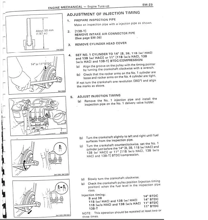

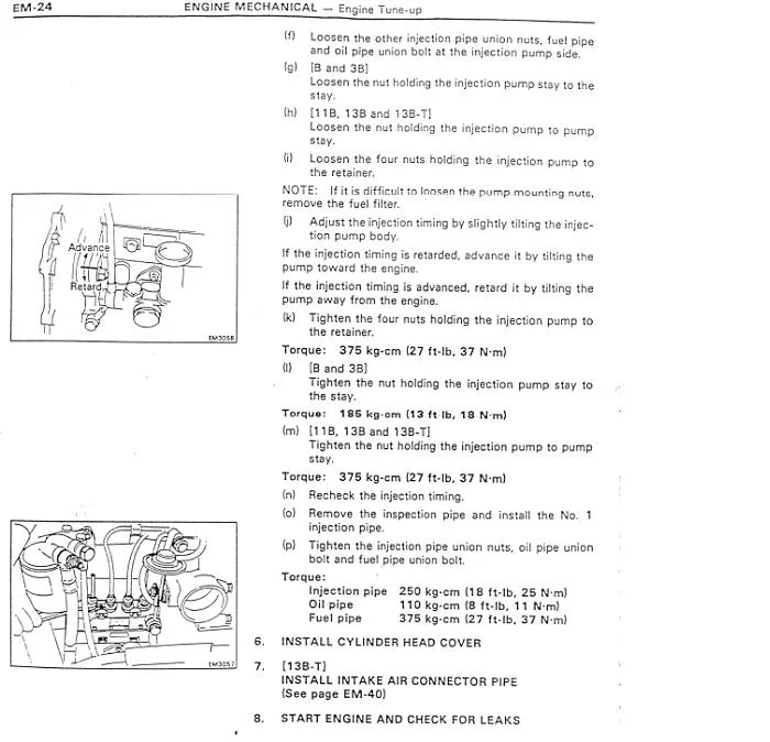

I hate to say you are all wrong, but...
Timing timing timing. Did I mention timing?
I chased down the white smoke dragon for months. New injectors, new glowplugs, manual override on the glowplugs etc. By chance one day I met with the diesel mechanic at the local Toyota dealer and he looked at it for 5 seconds (literally) and said "timing".
Loosen the bolts and rock the entire pump assembly towards or away from the block (mark it where it was first!!). Towards the block is advance and away is retard (I think, it's been a while). To do it properly you need a chunk of tube of the same diameter as the injector lines (preferably an old injector line piece 26 mm in length). It is all outlined in the FSM.
Seriously, no cost involved, and you will be amazed at the results. Try it first before you do all that other stuff.
The reason it needs adjusting at all is the springs on the timing gear wear and do not give the same resistance as they used to.
Hope that helps,
Craig.

regarding timing...
Is there a way to check the timing like a gas engine....with a timing light/strobe?
Tim

As for affecting the whole running of the engine...yes, you might not notice the loss while it is running or warm, but it is there. At start up (and this was on a fresh rebuild) it was a horrendous and smelly smoke show with it bucking and snorting and being virtually un-driveable until it warmed up. It made me very popular at work.
I moved my fuel pump between 1/16 and 1/8 of an inch and that was all the difference. It's very sensitive.
Again, MARK THE SPOT on both the pump and the bracket that holds it before you start. To do it right find a chunk of injector tube and follow the FSM.

Yes and no. Can you check the timing? Yes. Is it like a gasser? Absolutely not.
Please see the attached pictures.
Craig.
