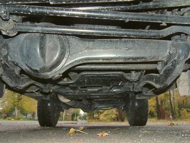

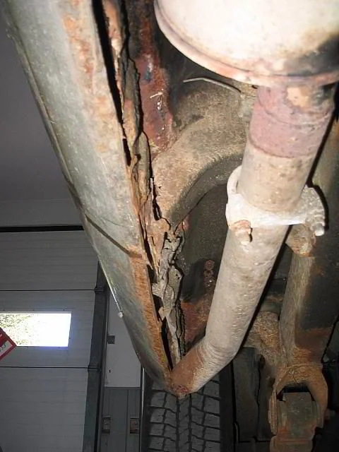

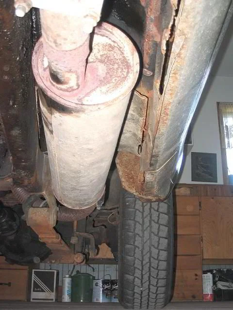

Back to the original topic of this thread, I did a lot of thinking lately. Upon closer examination, I noticed that not only was the front pipe still OK, but so was the muffler, although it was mounted upside down (the drain hole is in the wrong place). The only really bad part was the intermediate pipe which was patched in about 3 places, and the tailpipe was rusty.
There were two logical choices:
1. Replace the bad intermediate pipe and tailpipe, which is about half the length of the entire exhaust ($200 cash, no receipt)
2. Go all the way and get a good quality custom exhaust, front to back ($600 to $1000 + tax, or a partial exhaust at Midas for $450 + tax - for an intermediate pipe, muffler and tailpipe)
Since my funds are a bit limited right now as I plan for my move out west, I opted for choice #1. Man, I never knew a BJ60 could be so quiet! I can actually hear other noises I was never able to hear before. No more raspy exhaust! And I'm quite confident the exhaust won't break apart on the 4000+ km drive out west and make me go deaf. It will probably last a year or maybe even a few years.
The guy also put on a tailpipe with a downward spout. Although it still comes out at the back in the stock location, I'm hoping the diesel soot will go on the ground and not on the car parked behind me or on the garage door (I always back in). Not sure if this new setup will last a long time or not, but when it goes, I'll get a nice custom exhaust front to back, no expense spared. Thanks for all the great tips. I know how to put together a great exhaust for my BJ60 now. Not sure if I'll add turbo, but it's up for consideration.

Good choice, as it's invariably the back that wears out first (condensation).
If you ever wish to put a 'short and sweet' muffler, here's a couple of pictures I took yesterday of the setup on my old rig.
Whatever you do, don't you comment on the rust and the state of decay of the system!!! That truck has lived more than 23 years in Quebec used daily in the salt and sand of winters and done more 600,000 in those conditions!!! It's under restoration now!! Bon!!!
The pictures are simply meant to show how a simple muffler system can be made to fit in that space below the passenger seat, between the frame and rocker panel (what's left of it anyway )

That looks like a good set-up! I was thinking of something like that, but wasn't sure how it would look. I'll definitely keep that in mind for my custom exhaust set-up, whenever that may be now.
As for the rust, it doesn't look that bad. My BJ60 spent 22 years in la belle province aussi! Oil sprayed every year at Métropolitain by the first owner, and by me this year (though there was a second owner from 2003-2006 who didn't seem to do much maintenance, he just drove it). But, mine has only 332,000 kms. BTW, I used to live in Montréal and the West Island, but bought the truck in Ontario.

Thanks for your understanding... I HATE rust!!! Can't understand why they can't make cars that DON'T! Probably because they DON'T CARE... As except for where we live and few other areas, cars are not subjcet to the abuse our roads department and our climate subjects them to...
I have still not rustproofed my HDJ81... Look at how it is from underneath... quite a difference, isn't it!!!
For rustproofing the best thing to do here is to REMOVE the internal panels to access all the crevices... Done like that, after 7 yeasr even a lowly Suzuki presents practically no rust (and they are renowned for rusting fast).
But taking the whole insides apart!!! Hmmm... I don't think I'd have the nerve... I'll end up doing the undersides myself and shootiong the doors and panels at Métropolitain or some other place like that...

Good idea on the taking out the interior panels to do a good job on the rust proofing. A lot of work, but certainly worth it!
Your HDJ81 looks really clean! It almost seems a shame to expose it salty roads...
