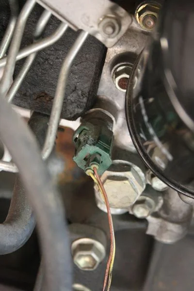

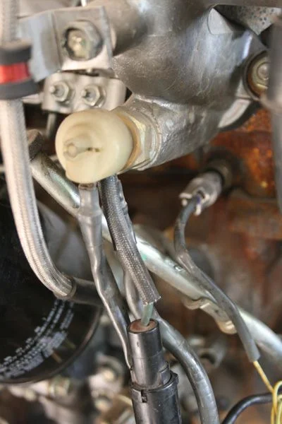

Can anybody tell me what this electric thing on the intake is for? It does not seem to show up in the FSM, seems to be part of the glow plug system.
I was under the impression that the small sensor in the background of the first pic was the water temp sensor, if that is the case what is the sensor behind the oil filter in the second pic? Do the HZs have an oil temp sensor? The oil pressure sender is just like the 2F.

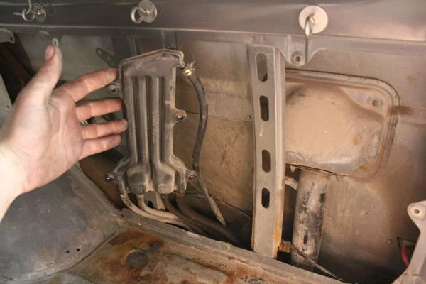

Do diesel tanks need this vent thing-a-ma-jig? I would like to remove it if I can.

That thing on the manifold is a temp probe. I think that it and the oil temp sensor help decide how long to glow the engine for
There are 2 coolant sensors,one on the block and one on the radiator outlet.
I plugged in the 3F temp wire to the radiator outlet sensor. (aussie spec vehicle take the coolant temp at the thermostat on 2F/3F but you could still use yours from the cyl head to plug in there i think)
Im not 100% sure if a 1HZ uses the block coolant sensor for the gauge or for the glow system.
My HZJ75 sensor wire is cut at the radiator outlet but the gauge seems to work ok and so does the glow system

Vent thing a majig. I didnt remove mine ,assuming that I have one,and everything works ok
I would leave it unless you have a full understanding of what it does.I cant find anything in the manual(s)

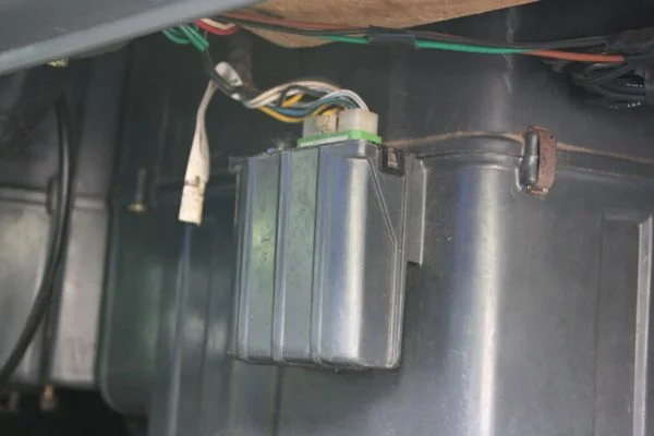

Rosco, Your FJ70 should have had a B-R (us spec is just B) wire to your AC amplifier labeled "from coil" The 60 series amplifier has a magic blue knob on the top of it (barley visible in the photo). This knob adjusts the minimum RPM that the AC pump will run at. I am under the impression that the AC will not run without that signal from the coil.
The Tach could just be a non-issue, but getting the tach to work ensures that the AC will work (I hope) so I hope to kill two birds with one stone.

I will keep the fuel expansion vent thingy.

I think I will just find a temp sender that works and ignore the rest of them, unless further info suggests otherwise.

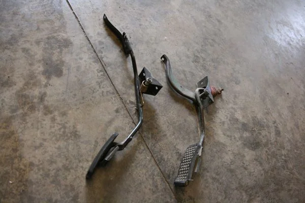

Here is a side by side comparison of the 2F and 3FE pedal assemblies. (3FE is the clean one) You can see that the mount plate on the 3F is smaller, will need to drill new holes, and drill for the cable.

My apologies ,it seems my aircon was wired into some wiring that had something to do with the coil although its no longer there.
I forgot I had to take it to a shop to have the 3F a/c hose fittings modified to suit the 1HZ compressor and filled with gas.
The guy did a good job but didnt speak much english and Im not good with electrics,so how he rigged it is beyond me although its neat and works perfect.
Note the bracket is also the engine lifting lug.
The wire with the blue terminal use to go to the 3F thermostat. The 1HZ and 3F temp sensor were almost the same so I plugged it ,hey it works

Ah, thank you very much, I am starting to understand more and more. The AC pic helps a lot.
Rather than a temp sensor, my HD-T turbo coolant return line is plumbed in to that port. I hope one of the other ports is a viable temp sensor.
After a clarifying phone call with my dad it appears that the 62 AC amp can operate independent of the coil signal, the 60 and 62 amps share a plug housing so hopefully it is a plug and play way to eliminate the need for a coil signal.

The factory '60 series diesels with A/C have a different A/C amplifier and they are not easy to find nor are they cheap! They do however share the SAME plug and mount the same way on the evaporator.
Does your bellhousing have a sensor bolted into it? If so you could possibly use the 2H or 3B factory tach found in Canadian trucks. It utilizes a "Hall" sensor. If that sensor is bad or missing they are also a little pricey.

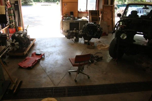

Made some progress today, there are now two motors sitting on the shop floor. It is days like this that make you realize just how easy cruisers are to work on.
Very satisfying to take things out of the engine bay, ".....wont need this, wont need that, wont need this............."

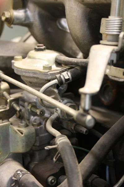

AC: The 62 AC amp looks very promising, it works the opposite way of a 60 amp, instead of receiving an RPM signal from the coil, it SENDS a signal to the ECU to tell the motor to speed up. Therefore the AC operation is no longer dependent on engine speed. It should work.
The engine will no longer speed up when the AC clutch engages, but I do not think that should matter that much with a diesel.
I hope it does not come to having to source a diesel amp.
Test, what is missing from this picture?
The FSM calls it a No.2 Overflow Port Plug, is it as simple as it sounds, a plug? Any body got a part#? Or a suggested length?
Are you using the vacuum fast idle for the aircon?
