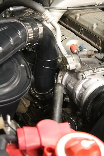

Got a box from G&S today containing the goods for AC, spent the evening getting it all hooked in (appointment in the morn to charge it up, so no choice)
I had to rebuild the air intake tube to clear the AC pump,
The lines actually ended up working out:
Firewall to dryer, 60 hose
Dryer to condenser, 60 hose
Condenser to pump, 62 hose (took some coaxing)
Pump to firewall, 62 hose. This one was the bitch. The 3FE pump sits low, just like the 2F, the line therefore exits the pump at an upward angle, the hood closes with it in that position, but kinks the hose a bit.
I was not going to take no for an answer so, on the advice of my hotrod friend, I wrapped the aluminum part of the hose very tightly with wire and attempted to bend it, I soon found that the hoses are WAY tougher than they look, I ended up having to use a bench top pin bender to slowly work the bend out of the hose. It does not look pretty but it goes right over the intake tube and does not even touch the hood liner. Now lets hope it all holds pressure.
