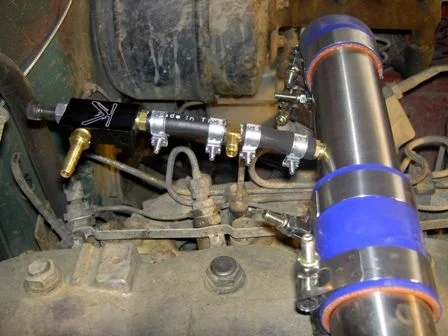

Ok! Got the oil situation sorted out - YAY! I ran a 1/2" ID hose straight into the oil pan and no more oil! Thanks for the help. Cruiser_guy - how did you run a 1/2" line to your oil return on the pump? My pump only has a 1/4" OD tube going into it for the return. Did you change that somehow or does your pump have a bigger return inlet on it? Anyway, that problem seems to be solved, but I still have very little boost, although I can feel the power difference when I drive, so I think my guage may not be reporting correctly. I have attached a pic of how I have the boost controller and the outlet for the boost guage setup. The hose barb closest to the firewall (coming out of the boost controller) goes to my wastegate actuator, and the other one goes to the guage. Do you think the guage should be tapped in closer to the turbo/at an angle to catch air flow?

Location: Victoria, Australia
Posts: 229
very shiny!

Posts: 229
I noticed that the boost control screw looks like it is screwed out. if you screw it inwards it should gain more boost. the more you shut the valve the higher boost level. do this at intervels and test , repeat if ness
