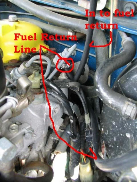

Sea Foam-ed the engine, proccess and pics
In earlier threads I have mentioned some of the issues and test results from my engine.
Well in a never ending quest to keep the girl running well for as long a possible, I have decided to use the Sea Foam product.
3B. 449,000kms. new glow plugs, rebuilt injectors.
Below is the process I used and the results it had:

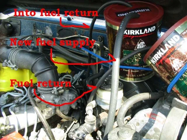

I purchased 2 cans of Sea Foam (under $10 each) and 5' of 5/16 and 1/4 fuel line along with some clamps, fuel and oil filters and oil.
I used 2 coffee cans for this, in hind sight 1 coffee can and a much smaller container will do.
Remove the fuel filter and drain the fuel, fill up with sea foam, reinstall.
Punch 2 holes in 1 can and 1 hole in the other container (lid).
Fill the coffee can with equal parts 1 can Sea Foam, Diesel fuel (1:1).

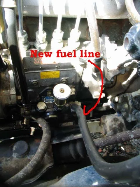

Disconnect the main fuel line going into the pump and plug the soft line, take a section of the 5/16 fuel hose from the Sea Foam/Diesel can and attach to the fuel pump. This is your new gas tank.
Remove the fuel return soft line (at the # 4 injector) completely. Take the 1/4 hose from the Sea Foam/Diesel can to the input of the fuel return - the hard pipe that goes back to the pump.
Take the out put from the return line (injector side) and with 1/4 hose run it to the other container. This is done so that whatever dirt is in the pump is washed out of the system and does not circulate back. There is not a lot of fuel returning so a smaller container is fine.
I ran my engine at idle for 10 min, then 2500RPM for 20 min and then idle again for a unitl I almost ran out of fuel in the can.
Replace the fuel filter with a new one - if you fill it with diesel it makes it easier to start. Reconnect everything and fire it up. Some bleeding may be necessary.
I then used 1/2 can in the oil and ran it for 30 min, alternating speeds from idle to 2000RPM.
Drain the oil, change filter, refill, run.
Finally I noticed a lot of black build up inside my intake, in my case this must be due to the slight leak at the intake valves. I slowly pured Sea Foam into the air intake (once the air filter hose is removed) with the engine running, to help clean up the manifold and the valves.
