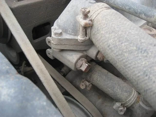

3B running hot
Hi,
I say running hot, when it fact i have nothing to compare it with. Anyhow i drove 350miles yesterday, and while cruising at about 65mph, temp needle would get pretty close the to first right white line of the original gauge, that doesn't tell much in degree, but that is all i have. I felt like it doesn't go that high usually. Truck stayed 7 years in my garage and who knows how long the last coolant change was done before i got the cruiser in my garage in 2000. So i'll flush it and change it. Now i didn't know there was coolant for diesel, anyhow that is what i took, motormaster for diesel coolant.
Any advice for this change on a 3B, i never done this.
Also anyone with a 3B and original temp gauge, input on how far to the right you ever got your temp would be great!
Also i think that running stock R&P @ 4.11 with 34" tires in 5th gear probably cause a greater load in the engine while the fan rpm being lower may have a impact, does this make sens? I try running in 4th and did not notice any drop in temp. Only sitcking the truck in the rear of a 45' trailer would help drop the temp.
I know has long has my 3B doesn't over heat it should last long, that is why i'm a bit worried.

When you change the coolant it can be a pain to get all the air out. Park the truck pointing uphill for the first few times and don't forget to run the heaters to get the air out of them too.

I found my engine will run hotter when I have a load (hill, crap in back etc.) now that I have 33s. I also find that even if I can hold a speed on a hill in a higher gear, if I down shift and get the rpms up, the engine seems to breath easier and gets the heat out. Somebody with more technical expertise can explain this--it was in a thread a while back and I can't remember.
2x on a flush and might as well just do a brand new t-stat while you're in there--if your cooling system is such an unknown and as you know heat can kill 3B heads, I would go for changing out the whole kit and kaboodle.
Do you have your rad curtain up? ;-)

For one of the few who still has it, yes that is the first thing i check. yesterday i checked coolant density at a local 4x4 shop with a friend and density was -45 deg C? and said it was fine, color was a nice green.
Maybe a new t-stats would be a good idea, I guess changing it requires a full drain? i'm not sure where it is located.
I still think the problem is mostly due to lower rpm of my engine when running in 5th gear.
What is the consensus, stop when the temp needle reach the first white line of the gauge?

I had good coolant but wanted to put in an 82 degree t-stat. It sits in a housing high on the engine/just off the front of the head, so I got a big pan, opened up the housing, let what wanted to drain go into the pan, switched t-stats, hosed off engine, filled and burped coolant. Quick.
But I bet your situation is just normal with the big tires.
When mine creeps up there like I said I just downshift, slow down, and not try to push a big gear and it cools down fine. In one day I climbed from the floor of Death Valley to Monitor Pass (-200 ft to 8300 ft elevation) and yes it would get hot and yes I spent a good deal of the day in 3rd gear, but it did just fine.
B

3B's don't run hot unless they arent getting enough air, or coolant flow.
Check your rad to make sure the fins are clean - wash it out from the inside out.
Replace your thermostat and flush system.
Check your rad cap.
Make sure your waterpump is working well, and make sure your clutch fan is in good working order - maybe replace it if it is original.
34 inch tires in 5th gear shouldnt bring temps up that high in this part of canada.
Also, if your truck gets really hot and you want to cool it down, turn the heater on full blast - rear too - open the windows and floor vents and let it cool down at idle.

I don't agree. With stock gears and 33's 5th would be lugging at lower rpm. Lugging produces heat doesn't matter if it's in 5th or 2nd. Basically at sea level with a stock truck if you lug the motor it will get hot. I agree it needs more air

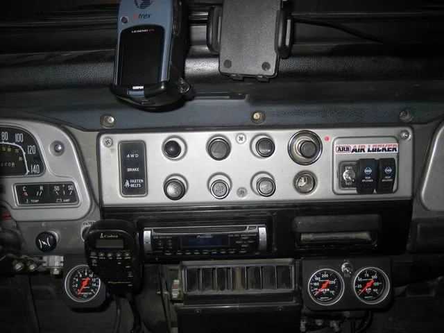

Yesterday i installed a autometer water gage, at the same time i replace the poor viair gauge with a autometer air pressure. BTW my piro still doesn't work.
I was planning to install the mecanical sensor where you see the plug. Anyone has good advice to get that (mostlikely steel) plug out of that aluminium housing without messing the threads, or without removing that housing from the block.

Also, since i started this thread i cleaned the rad inside out. Since then i drove 2 hours srtaight and the temperature gauge never crossed vertical, much cooler then my last long drive. But this time weather was cold, 10-15 deg C cooler then the drive before.
Once i get that water gauge working i'll report back how high it goes.

Cell picture... hope that help (I use a plastic cover on the metal sensor)
Be carefull when removing the original sensor.

David,
I kept the original sensor in and plug the new on the plug you seein the picture, i guess it was a drain.
Anyhow i finally got the square plug out and sensor installed. I since then drove about 5 minute and temp went to 180 deg F and stayed about there.
__________________
