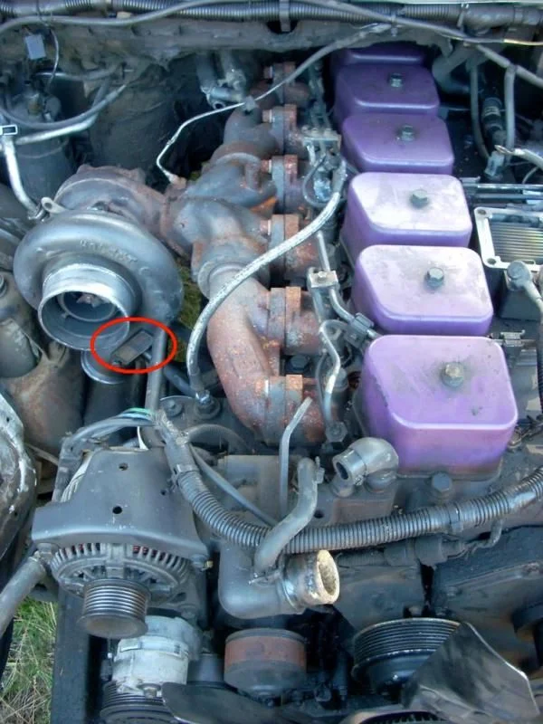

The best way would be to look on that tag and get the numbers. It should tell you the model. Mine didn't so I had to google the only number I had to figure it out. I'm just going off of looks and what was available from the factory.

The one off the 94 pictured above is the HX35w. The other is a H1C? serial number c0245324. I'll probably end up using the HX35 as its setup to run an intercooler low and be able to clear the hood better.

Heres some pics of the last few days at LCS and the grease system...which is fully installed and opperable.
Exhaust Turbo Downpipe:
Back and Muffler:
Tipparillo:
Bezels on, sidelights:
Sittin on 35's!
Turbo/Airbox
Intake:
Grease System:
Transfer:
Heaters:
Fuses
Huge RACOR filter with Arctic Fox
Grease Tank Cover:
I don't have pics of the tank or the finished product, maybe next week. Theres a rollover valve installed in the downpipe for the grease tank which is pretty sweet!

Sorry to hear about the accident. I might be doing the same conversion on a fj60, or I`m going to be using the 4bt in the fj60. Thanks for the updates, it looks like it would be a blast to drive.

Great job with that conversion. Another turbo to have considered is the HY35 that comes with a 9cm^2 exhaust housing. This makes it spool up faster at low speeds, yet still gives you great highway performance. I should be swapping one into my 4BT in a week or two.
MORE PICS PLEASE!!

It was for about 2 days! Hearing that whine was unreal! Its been a long project, setbacks suck, se la vie!

can you post picts of the airbox? did you use a cummins box, or make one? Great work, btw.
