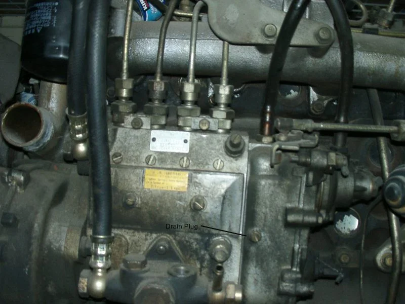

congratulation on the fix. The oil in there is what leaks past the seal on the fuel rail. There is a drain plug that you should open periodically but no one ever does.
great pic .. thank for posting.

Can anyone give me a pic of where the diaphram is located and what it takes to reinstall. I just ordered a new one and need to install but dont know how? After warming up my BJ42 is idling about 1500 RPM but used to idle at about 650-750rpm?ThanksRob
