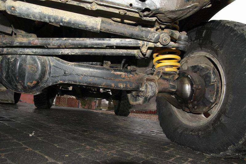

Influence of desert/sand on engine/transmission in HZJ80 (1HZ)
hi,
I have already posted this in 80-series forum, but maybe here is a better place to ask :-)
anybody has some experience with what is the influence of long time driving in deserts/sand environment on 1HZ engine and generally on diesel engine series 80 ?
maybe someone has been repairing engine, on transmission box from a car which has been used for a long time in such a dusty/sandy environment, and can comment on it's conditions ?
I am about to buy '91 HZJ 80, (1HZ engine) which was used (ie.) during Tunis Rally in Africa, and would like to know, if this kind environment can be very destructive to engine/transmission/other components.
car pictures and replays fron 80series forum here:
http://forum.ih8mud.com/80-series-tech/139825-influence-desert-sand-engine-suspension-hzj80.html
all comments would be welcome
regards
andy

The rear axle: both torsion rods were damaged. One was broken about halfway the diameter, the other one was hanging about, wedged between the lips of the bracket.
Front axle even worse:
The two axle arms (hockeysticks) are each mounted with three bolts. One bolt to the chassis, two bolts onto two brackets on the axle, one at the front, one at the rear of the axle body.
At both sides (left and right) the rear brackets were broken. One on the welds the other bracket tore a piece out of the axlebody. Once removed we could look into the inners of the housing, seeing the shaft !!
All that was holding the front axle in place were the front brackets wich we found damaged as well!!
We managed to get it all welded up and he was able to make it home. Forunately this happened in the last week of the trip and we were in a more or less relaxed mood and not driving at high speeds, because we were ahead of schedule.
Back home all was looked after and repaired. No problems with te engine, gearbox, transfer or driveshafts.

I get the overall picture now. I will be examining suspension more carefully, after reading your comments.

Finally, I did not buy it :-(
it was hit seriously from front-right side
the guy who was selling it, repaired it, but the quality of repairs was poor. I could see curvature on front axle !
the brakes did not worked. Transmission was in need for repair. Engine was leaking. Car was very heavily used inside. And guy was asking 10,000$ for it !
So I am still looking :-)
aklosak is offline   Reply With Quote
Old 03-03-07, 01:10 PM   #12
IH8MUD Addict
Ron R's Avatar
Join Date: Dec 2006
Location: The Netherlands
Posts: 538
Good job!
Pity that you have to look for another one, but better safe than sorry.
Now that you have this picture, next time look also for the points where the lower axle links connect to the axle. On your picture just left of the spring at the underside of the axle.
Why? That's is the point I described in posting nr 3 above. It was sheared at the left and righthand side.
Hope you're more succesfull next time.
