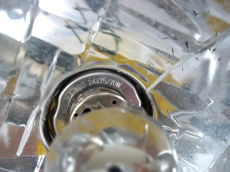

Just took it out. Sealed 24v 70w light.
I need the whole unit because the lens is smashed (damn winter rocks)

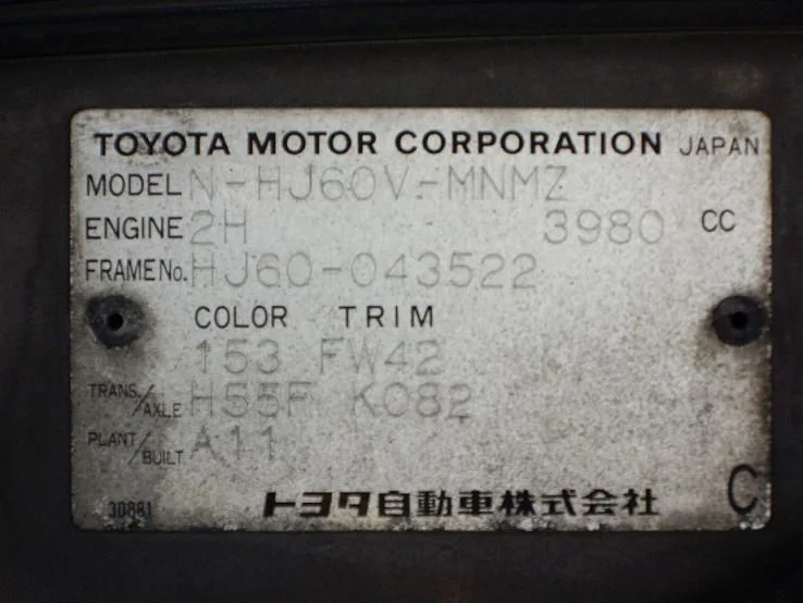

Yes I am 100% sure. I have an HJ60, with a 24v electrical system. I looked on that silver plate on my firewall which said (HJ60) and my headlight said 24v - 70w
So, does anyone know where I can get headlights? (Rectangle ones?)

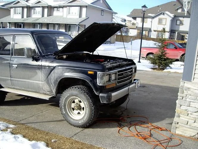

O.k. here are the pictures. 1988 HJ60. JDM-24vName:  Vinplate.JPG

That is a 24volt h4 lightbulp right? not a sealed?

HJ60 ... not Canadian Market ?

As you know, the HJ60 in Cdn trim came with 12V headlights, even though the rest of the truck is 24V.
David---The JDM HJ60 (2H not 12HT) is pretty much completely 24V like the HJ61.
Funksolid, you want some H4 LHD units, then source out the clear 3M product that covers the glass, and will not yellow with age. I need replace some lights on Petra's HJ61 due to cracked lenses this last winter...and somewhere in the depths of my e-mail records is reference to the 3M product.

Looks like that baby has a high roof, so it is probably a JDM unit. You want Hella lights:
Hella 72150 (Kit of 2 H4 low beams)
Hella 72151 (Kit of 2 H1 high beams)
Just take the 12V bulbs out that come with the lights and throw in the 24Vs. If you replace the high beams you have to insulate the housing as it will ground out and cause the highs to stay on. I used rubberized rocker guard on the contact points it has held up very well. Some people also replace the wiring harness.
