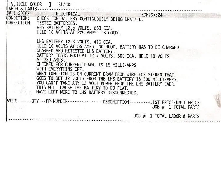

Here
Here is what the people wrote...
(Anyone on those headlights??)
I drive my Lc every day, and over a few days the battery slowly starts to die.
ThanksName:  Submit this.JPG
Funksolid is offline   Reply With Quote

First of all make sure all the battery connectors and the ground connetions to the engine is good.
In a 24 volt system both batteries need to be the sama size and in the same condition. Since one battery was bad, I recomend you to replace them both.
Then get a 24v-12v volt converter, never "steal" 12v power from the lower side battery. I´v been there and it was trouble all the way.
Try to get a converter thad draws no power unloaded. Connect it to the 24v power outlet next to the air filter house.
I would use a 24 volt relay to make me a 12v acc power so the radio turns on and off when turning the key.
In my old HJ61 (see pics http://www.pbase.com/haffinn/) I ended up adding a 12v alternator and a aux battery. I powered all the aux stuff (radio, amplifier, VHF radio, all the aux lights, my 12v cooler etc.) with the 12v system and kept the 24v just for the original stuff.
I had alot of troubles with all that 12v stuff and converters until I got the 12v alternator and 3 new batteries so I know your pain

As Haffi has said, you will need 2 new batteries and a converter. I've been using a Samlex converter for the last year and it works great and is reasonably priced. If you would like a detailed description of my install, let me know.

As mentioned you are stealing power from the low side battery. Get a converter and run your 12v accessories off of that. I run my CB radio, cd player and 12v cigarette lighter for charging cell phone and gps off it. I wired a 6 gang hella fuse block into the converter so I can quickly & easily wire 12 v accessories into the truck. As mentioned in your headlight post, your headlights should be 12v not 24.
