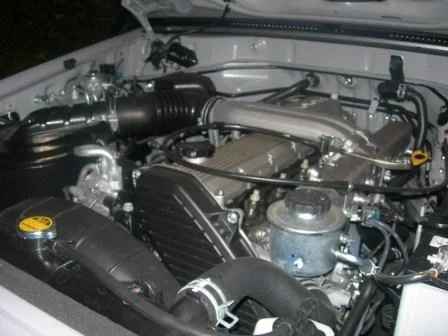

Hey guys! I am doing a research on a turbo kit for my land cruiser. I have found that the safari turbo from APS is a good one. I contacted the company to see if it would fit my engine, I even sent a picture of it, and they weere not able to confirm if it would fit...i have no idea why....the're suppose to know this things, maybe there are not interested to sell one turbokit to somebody so far away!! ..maybe because mine is a LHD? thats one of the reasons they tried to gave me...anyways...I would much appreciate your feedback on this. I want to install the safari turbo, and see if i can also install the intercooler...i have no idea if it would fit...maybe if you post some pictures of an engine with the kit installed would help me determine if it fits or not...
they also mentioned something about the firewall...
Thanks so much for your help!!
Im attaching a picture of the engine...and also the LC for all you LC fans!

Better for them to be honest and say they are not sure than send you a kit that will not work.
My guess is the turbo will fit but fitting an intercooler is difficult and even Toyota has not fitted intercooler tp HDJ7* because it interferes with the airflow in the engine bay.

Thanks for your reply roscoFJ73! you may be right...but i have heard that the kit has been installed before in other LC....i just can find the reference from it...about the intercooler...yes...i had my doubts....but need help fitting the safari turbo kit...and finding out if it will fit in the engine compartment..

From that picture they would not be able to see if it would be in contact with anything in the engine bay. As Ross says if they said yes and it did not fit for some reason this would be a problem for them. You should be able to work this out yourself if it will fit. These pics are not of a Safari but will give you some idea. cheers

thanks for your reply bigbrowndog. Does that turbo has the same dimensions as the safari? How can i get the specs (measurements) so that I can see if i have enogh space ?
