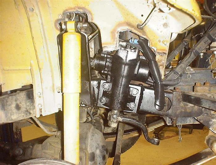

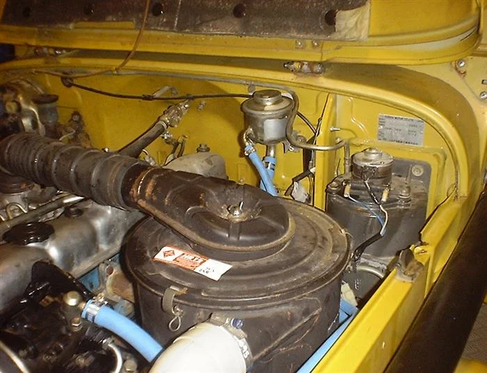

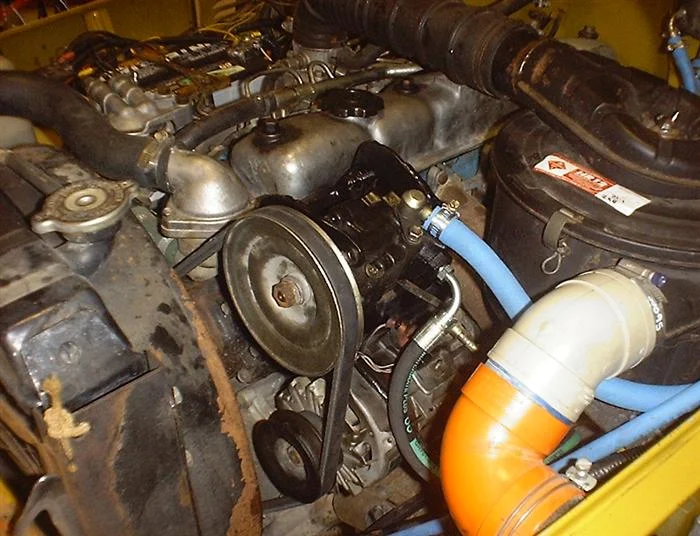

Well do to the lack of effectiveness of the A/C in the troopie, it was sacrificed... so I was able to utilize the compressor mounting space..... do to the limited height space between the hood and mounting area a mini truck pump & reservoir was used ......here are some pics of the conversion......

'85 Toyota Pickup pump and reservoir....

is that enough belt contact for the alternator/air vacuum pump?! does'nt look like a lot to me.........

Hi, i'm new here and am looking for any info on 60 series to 45 series pwr steering. would be appreciated if you could send me more pics of what u've done Also any info from anyone in regards to putting a hj60 5 speed box behind a 350 chev (into fj45 trayback) been in contact with Marks Conversions, he has all the adaptor bits, just wondering if any other hassles will pop up...?? Thnx, jan
