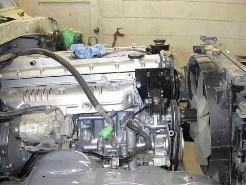

I imagine ENS sells block heaters for the 1HZ and 1HDT, I have a mine truck engine and it has a block heater in it. I always liked the block heater, the engine is always toasty. My truck has a block heater in it and I installed a low rad heater to see the difference, I'll be checking it out shortly - I'm just finishing up the truck now.
In my estimation the difference between the 2 is marginal - but will find out soon enough.

curious, where did they locate the block heater...i have yet to see a factory block heater in any 1HZ, HDT, 1PZ....

You can just barely see it behind the blue capped A/C hose. Did you ever call ENS to see if they have them?

first frost plug behind the thermostate housing...
interesting...

i just checked the EPC and couldn't find a listing... i wonder if it is an aftermarket heater...
