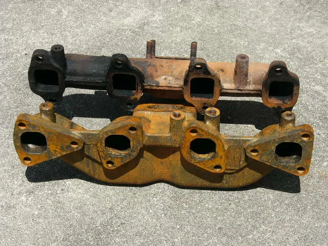

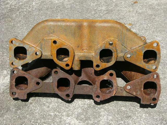

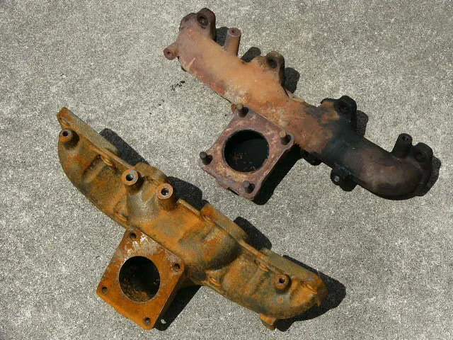

While searching around for parts i stumbled aross this 14BT exhaust manifold.
Ive never seen a 3BII in person, but i had an old headless 14B from a Dyna truck that came with the exhaust manifold. I ended up throwing most of it away, but luckily i held onto the manifold.
According to the EPC the exhaust manifold that is on the 3bII equipped BJ70 is the same as that fitted to the 08/88> B, 11B, 3B (3BII) and 14B powered Dyna trucks.
I cant say it will definately fit as i dont have a 10 stud head to try and fit it on, but you can see in the photo the stud pattern has to be the same.
The 14BT uses the CT26 as well, so the 13BT turbo will fit.
If anyone wants to price the manifold up, the part number is 17141-58020

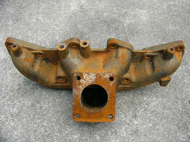

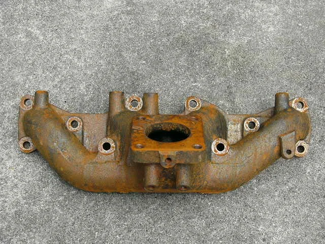

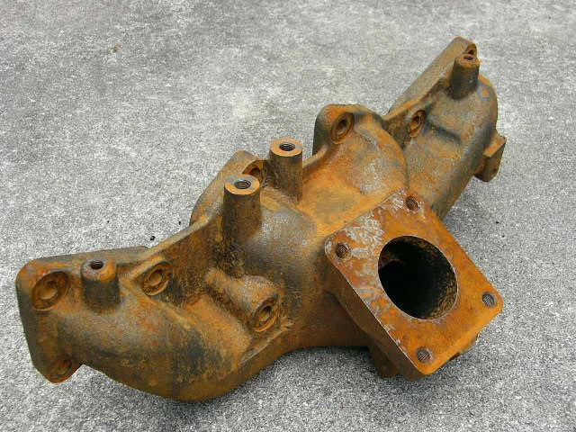

A couple of pics with a 13BT manifold

i made up 5 adapters for the 13BT manifold to the 3BII, that manifold looks like the real thing...where were you when i need that manifold?

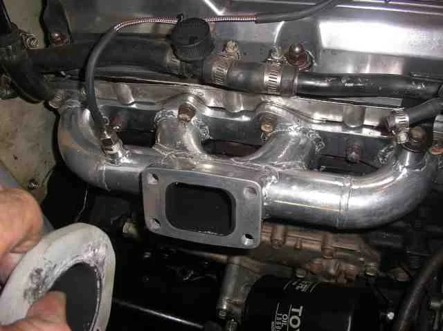

i needed one of those , it looks really well designed
this is my version

Hey Indian, is that an alloy exhaust manifold or do my eyes decieve me. If it is alloy, how come it isn't a puddle on the floor?
ozwallaby is offline   Reply With Quote
Old 02-21-07, 11:06 PM   #6
IH8MUD Rookie
Join Date: Mar 2006
Location: Vancouver BC
Posts: 34
ceramic coated mild steel
Indian is offline   Reply With Quote
Old 02-23-07, 04:49 AM   #7
IH8MUD Rookie
Join Date: Jan 2007
Posts: 68
Its got me beat why more x manis aren't made like this by owners. They do the job and you get to place the turbo where you want, within reason of course. Thnks for the info.
