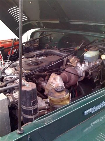

Its been about 6 month since the 4BD1-t conversion and I must say I was a little sad regarding my conversion decision due to a vibe I had in the drive train. I finally found it addressed the problem ( removed weight attached to flex plate) and I got to tell you I havent been happier with this rig even though I'm using a TH400. Listen learned remove the balance weight from the flex plate before installing it on your rig, it doesent require it. Now it pures like a kitten, pulls like a mule and starts up every time even in the middle of winter (top of the world) with no problems. Two big big thumbs up.

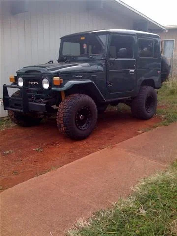

Here's for all the 40 fans. 4bd1t hooked to 4l60E. Fun to drive, just need some sound insulation now.

Listen learned remove the balance weight from the flex plate before installing it on your rig, it doesent require it. Now it pures like a kitten.
Is that the Isuzu flex plate or the GM?

Its a Chevy flex plate 6 bolt that was for a 350. Regardless what flex plate wither GM or Chevy you buy, you have to take off the welded on weight. If you don't you will experience crazy vibes ( not GOOD) that will eventually cause significant engine/drive train premature wear. If you notice the 7th hole in the flex plate (dowl guide) it is used to align the flex plate to the Chevy or GM crank so that the crank is balanced with the f.plate. In our case it's not required. Hope this helps...

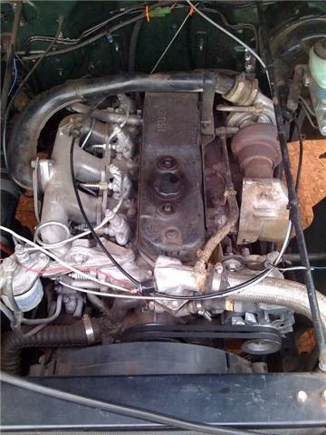

it has been awhile since i have posted any thing, but i have been doing some small tweaks on my fj62, and getting it out and using it!

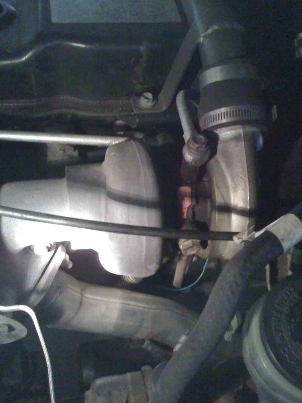

My latest addition was a new turbo, which I posted earlier in this string. This turbo has helped a lot in getting power out of the small 4bd1t. i have also had to replace the radiator awhile back, the old one had holes, and leaking in the core.
I have been driving on many roadtrips, taking the truck into the uintas mountains shown here. also drove it up to the Gros Ventre range in WY, to elk hunt this fall. it pulls great in the mountains, first gear, 4wd it can pull anything. i have not had in 4wd-lowrange yet. i can imagine it will be a stump puller.
It has been a great rig, and settling in to the conversion. I have wished for more power. I did some mods to my 1996 dodge cummins, altering the governor, and the cam plate that controls fuel flow. the results were amazing!
so i gave the isuzu more fuel. Turning the screw on the side, counterclockwise, one full turn, has made the engine so responsive! it has more boost, and more power. i have to really watch the EGT gage however on the hills. i can easily get to 1200F and need to back off, or shift to third.
I need an intercooler! the conventional intercooler looks like it can be an option, but has any one done a hoodscoop style? similar to subaru turbos, with a smaller cooler, that get freestream air at the top of the engine?
