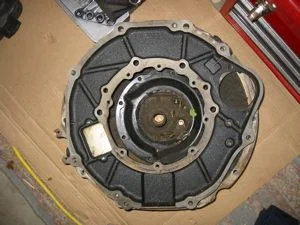

fj62 isuzu 4bd transmission
spent a month or so looking at the a440f bolt pattern, and the isuzu 4bd.
a shot of the a440 adapter from the toyota engine, sitting over the isuzu trans bellhousing. note these two components are what the plate would need to look like so that it could mount to the isuzu engine, and to the toyota auto trans.
This is roughly what it would look like.
I say roughly, cause i did not feel like the hole locations to be very accurate. I have roughly .050" that I am chasing around with measurements, or a compass arc. I feel like it needs to be in the .010" range, to avoid some gnarly vibrations.
I wanted to experiment with a wood trial part. although this would show if the adapter would bolt up, it would not tell you that the trans shaft, and the crankhshaft were centered. so I would have to mock up the cotton wheel spacer too.
I want to get my fj62 running, so I am committing to an isuzudieselswapper adapter, a 700r4 K case diesel transmission with a .71:1 overdrive, and a AA transfer case adapter to my landcruiser transfer case.
Its not going to be cheap, but it will be efficient, and reliable install. Honestly, it was not going to be cheap to rebuild the a440f to stand up to a diesel, and not cheap for the custom adapter.
I would like to continue working on this however. does anyone have a more accurate measurement system? a digital 3 axis milling machine, a visual comparator, or hell, even a granite block and a height gage? I have worked in shops like McDonnell Douglas, Leatherman Tool that had this accurate equipment.

Quote:
I'm thinking now that this is the better setup for a lot of reasons, not the least of which being that it seems a lot easier.

progress is slow and time consuming, 88tlc is/was working on an adapter and i will at some point make a plate adapter to run toyota everything from the engine. but i'm not in a hurry as mine is up and running great.
i think the H42 will be fine if your not running high speeds. i also think with daves adapter you will be able to keep the tranny in the stock location, good for many reasons.
problems with the A440 are the adapter right now, it doesnt exist. problems with a 700r4 are the same as a v-8 conversion, but i would be a bit concerned with front shaft clearance, unless you can figure something out you cannot favor the driver side with this engine cause you have a big starter right there, so you will most likely be running a skinny front shaft, which is no problem.

i have a side by side pic of the two engines when i was doing the swap several pages back, you can see in the pic and you should have seen with the tape that the isuzu is not any taller than the 2F, in fact, its shorter under the hood. having this engine under my hood is good for you guys cause i can tell you physically how it looks. i put the engine low in the frame, i easily have 4" of clearance to the hood, plus,, i kept the engine off the firewall about 6",,, if the engine was against it like normal and lifted a couple inches i think the oilpan would clear the front axle with no lift and maybe, maybe just a little notch in the corner.
its a rehash for some of you, but i'm sure there are a few who havent seen the pics.
http://forum.ih8mud.com/fj55-iron-pig-preservation-society/157088-enough-talk.html
