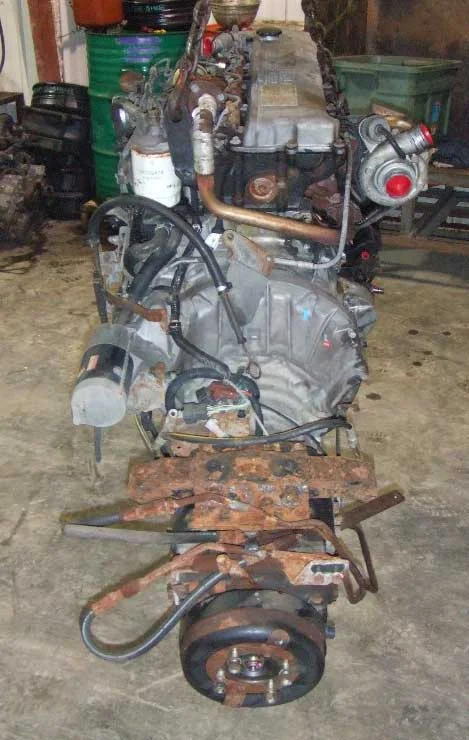

The primary difference between the 4BD1T and the 4BD2T is that the 4BD2T is indirect injected whereas the 4BD1T is direct injected.
Here is a pic of a 4BD2T head. Two of the precombustion chamber inserts are missing on the left two cylinders. (Precombustion chamber = IDI)
Personally, I wouldn't be too concerned about DI or IDI.
