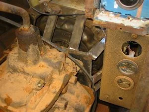

thought I would share a great bellhousing I saw the other day.
john deere to a chevy 4 speed. he lasered up the crank and the input shaft, and started welding!
he did a good job on it don't you think? like factory!
this was on a stationary bandsaw, powered with a 4 cylinder johndeere diesel.

bellhousing -tacoma WA style
Quote:
Originally Posted by RHINO View Post
88tlc that pic you posted is pretty much one of my ideas to adapt. well its along the lines of two ideas making a steel bellhousing and putting all landcruiser clutch parts right on the isuzu flywheel.
how has the modeling come along? I am sorry I can not remember who was actually doing the drawing, but that is always great way to work with a machinist, on a plate that allows the bolt pattern and diameter to be married.
this method looks great, and on this large band saw and stationary engine it was fine.
I do think an adapter plate and using the TLC bellhousing would take less energy,
another pic of it.

3fe and a440f engine out, ready for the isuzu 4bd
andre and I took worked on the fj62 this weekend, and removed the engine and tranny.
got the transmission off the engine, and getting ready for the 4bd/a440f hook up.

Great! I can't remember... are you planning on a custom adapter?
