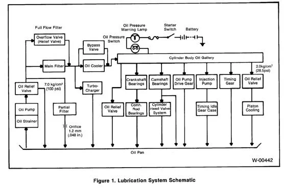

No oil pressure at idle
Quote:
Originally Posted by RHINO View Post
so, i had a tight fit to get the oil sender on where the stock oil sender goes on the BD1,,, so i located sender on other side above starter in the oil galley plug next to that cap for who know what? i get oil pressure when revved up but goes to zero at idle, anyone know about this? seems kinda wierd, i am using a brand new toyota sender to match my toyota guage, so the electrics and sender and guage should be fine.
BTW i been doing a half ass build thread on the FJ55 section,, its all done and i'm driving it now, such a big smile on my face its stupid.
http://forum.ih8mud.com/showthread.php?t=157088
Congratulations on getting it on the road! I'm looking forward to hearing your opinion on the conversion.
Regarding no oil pressure at idle: I would worry about that. The manual specifies 14 psi at idle (650 rpm), I suspect that you may not have taped your sender into the main oil gallery. Is there a way to temporarily connect a mechanical guage to the original sender location to verify that you do have good pressure?
I've included the lubrication system schematic. Unfortunately, it doesn't show where the galleries are located on the engine block.

i'm sure it just not a good location for my sender, i havent put on a mech guage to check pressure but it squirts oil at idle, so its being pumped, i'm sure everything is fine. i'll just need to get my sender over to the other side in the original sender location, no biggie.
thanks astr
