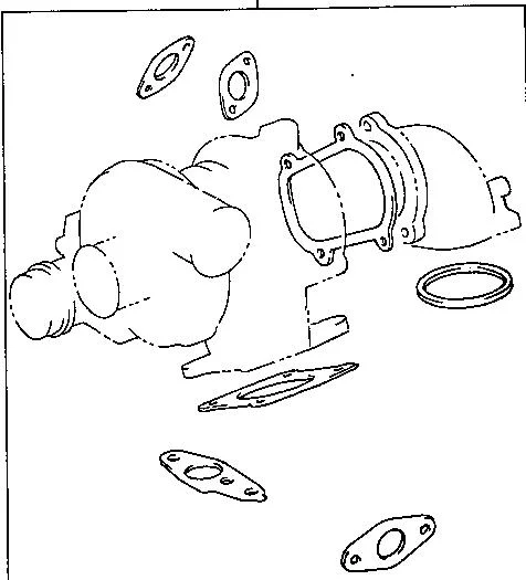

I need to remove and replace my 13BT turbo to install a pyro.
Can I reuse the gaskets for the turbo, water and oil bypass or do I need to replace them all ?
If I need to replace them --- where can I get them? The Canadian BJ70 (3B?) did not have the turbo so I can't get them from Toyota.

The two big steel gaskets usually survive, the exhaust donut is best replaced. The small paper gaskets on the water and oil in/outlets usually tear.
If you want the genuine Toyota 13B-T gasket kit we have em in stock.
See pic
