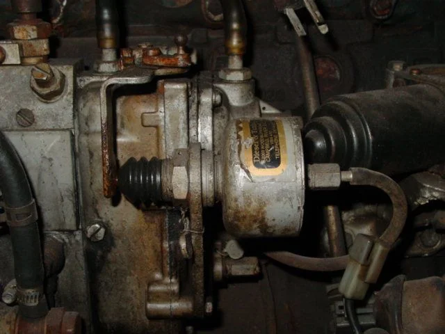

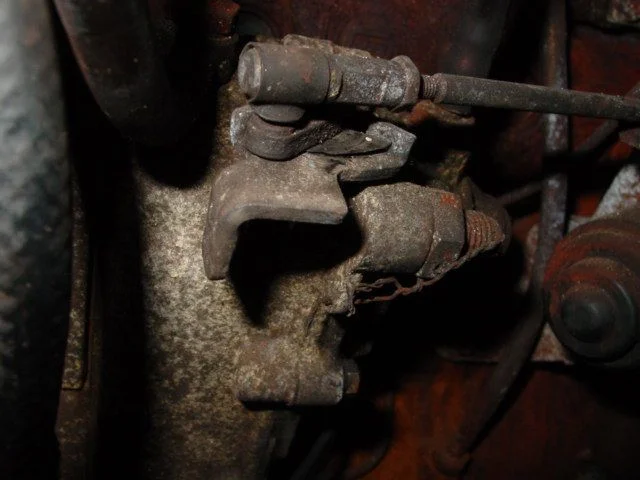

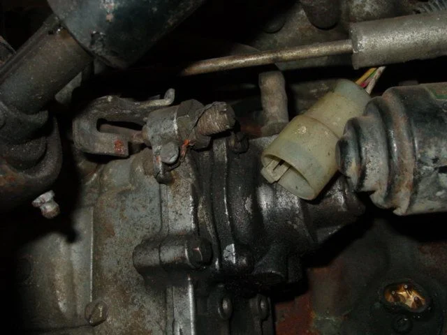

here are three pictures for you:
The first two are of two different views and are also of two different engines, but both from BJ60s.
The last photo is from a BJ40 engine (B) but is the same as a BJ42 3B for this discussion.
So, looking at the last photo, you will see the "can" to the right with the sticker on it that says "diesel", this is the HAC. The nut you need to loosen is the one a bit to the left that has the wire threaded through it.
If you back out the HAC (so it moves to the right) you'll increase your fuel. Threading in the HAC will decrease your fuel.
Put a mark on the HAC so that you know how far you have gone one way or the other and keep a note somewhere of what you have done. The real and true amount of fuel (as determined by the FSM) can only be done by removing the pump and bench testing it, so it's at least nice to know where you started from in case you want to go back to the neutral setting.
hth, and your mileage will vary after this discussion... (but so will your power)

Andre, the second picture shows a electrical plug, just below should be the adjuster, behind the EDIC motor, tough space but sure thats it.

we ended up adjusting big nut on the altitude compensator. Works great and is noticable.. We only went a 1/4 turn for now until the EGT probe arrives tomorrow.. Looks like we will probably put post turbo for now for ease of install.. Even though I am a pre turbo kind of guy usually Thanks again everyone.. Who knew BJ42's have HAC's - cool..
