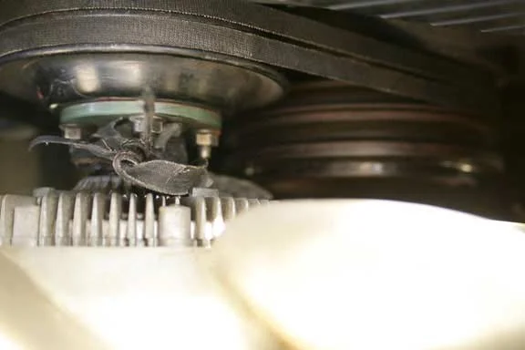

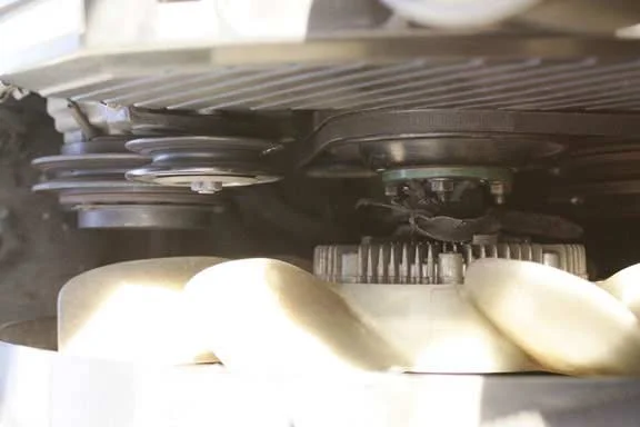

Also will be looking for a new belt.. and someone to replace it?? Checking out all my gear, and suddenly hear some flapping when my ac/heated is cranking... then a horrible smell of burning plastic.,.. Under the hood find this.....
I just moved to Calgary... have no shop to work in, and in reality need a FSM bad. Anyone that could offer a hand would be great.

See the idler pully there? Loosen the 14mm nut on the front of it and then loosen the adjuster on the top all the way down. Fish the belt around the fan and over all the pullies. Tighten the adjuster till you can just wiggle the belt. Retighten the nut on the front. Join the Rocky Mountain Land Cruiser Assn and next time you have a problem you'll have a buddy to call.

How much of the belt is left?
If it's intact but in one long string. You can take it to almost anyplace and they can size it up for you. It might be easier that way. Might take awhile for someone to find the part number and get it back to you.
Or if yours is shredded I can take one of mine off and get you one after we size mine up.

The part number is 99332-11260, should be available at your Toyota dealer
lenth is 1260mm if you want to go the the auto parts store.
By the look of your belt you may want to check the AC compressor to make sure it is not seized up.
