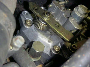

Fixed the injection pump today.
Here is a photo of the governor adjustment lever (throttle control for you non-diesel types).
The fuel was leaking out from under the spring when the engine was running.

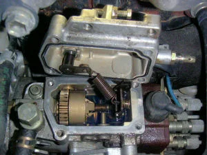

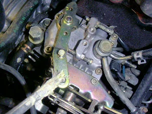

After pulling the fender mirror and the forward battery, I started removing some of the brackets and wire clips from the top of the injection pump.
The pump cover is held on with 5mm allen head bolts. You will need a 3/8" drive allen head driver to remove them. Mine were very tight, had to use a breaker bar with an extension to get them loose. Some of them require a swivel extension to get the 5mm tool into the bolt.
SUGGESTION: Suck all of the fuel you can out of the hole exposed by the fuel return banjo bolt (the 17mm head shown in the first photo). I thought about it after I removed the banjo bolt and saw the fuel inside the governer. The fuel would have spilled all over the place when you loosen the cover.
If you notice in the first picture, the shaft that goes through the cover has pulled down quite a lot due to the spring tension.
Be very careful when removing the spring and the retaining clip on the governor control lever (right side of the cavity). If any of these parts fall into the housing you are screwed!

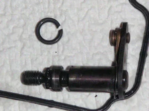

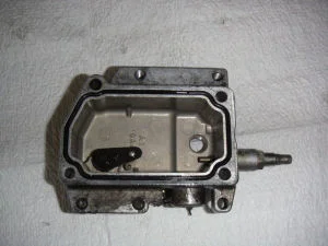

The control shaft was pretty much pulled out of the cover by the time I hit the bench. The oring was intact but pretty flattened. When I removed it from the groove, it split in two really easy.
I am guess that the fuel has hardened the rubber and shrunk it.
After I replaced the oring on the shaft (and the large formed oring on the cover), I had to lubricate the rubber to get the shaft back into the cover. It was quite tight. The old oring was shrunk down quite a bit.
After cleaning everything and putting it all back together, (dont forget to lubricate your balls!! ) I started the engine... started right up and died.... After a few pumps on the priming pump, she re-started and was running perfect.
