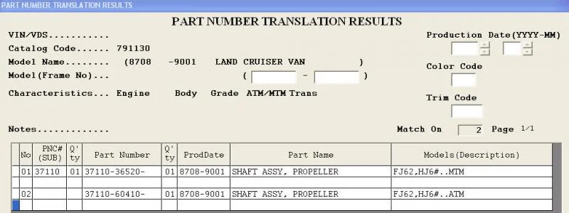

Does this answer your question?

I guess that tells me that the A440 and transfer are in the same place. Still not sure about the motor mounts.

You can find a lot these answers by comparing part numbers.
compare the brackets for the respective models at
http://www.toyodiy.com/parts/ or get Toyota EPC loaded on your computer.
The engine mounts (part numbers) are different.
Whether or not they can be moved and or modified slightly to work is for you to find out when you get
to that point in the conversion.
At least the stock tranny mount/x member is the same and therefore dictates the position of the 12H-T.
