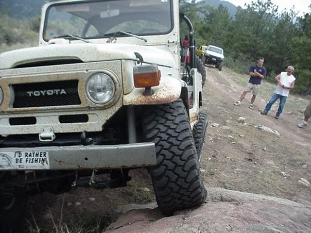

Update: Post Cruise-Moab '06
Well, I didn't get to wheel the 40 in Moab, but Kipper did, and the PS system did just fine! They wheeled Hells Revenge and Poison Spider
I wanted to try to get some sweet shots of the 60 PS being articulated, but since I wasn't there, my buddy O'Neil took the shot below.
After driving over to Moab, I think I need to check my caster and add a steering stabilizer. The steering is a little darty when I brake hard. I am guessing I do not have much caster and will need to add shims. I just hope the front flange won't get pointed down too far!

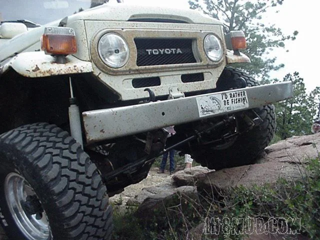

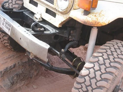

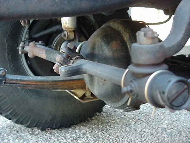

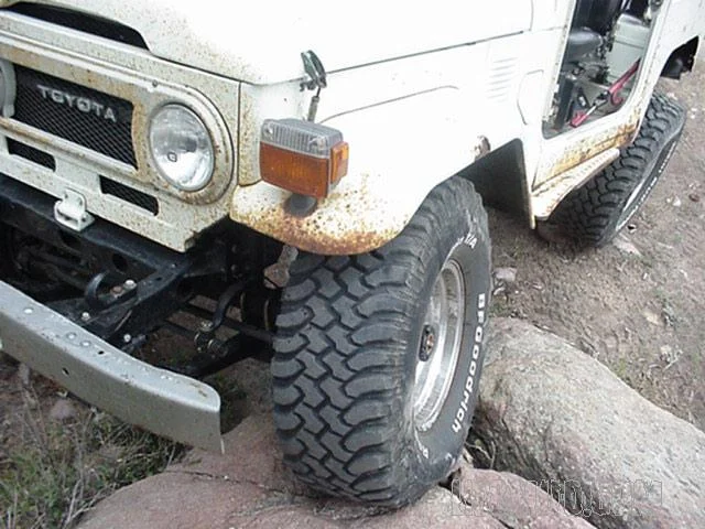

Steering clearance while articulating
Thanks Y'all!
I finally got some pics of the clearance betwen the steering linkage and the leaf springs while flexing:

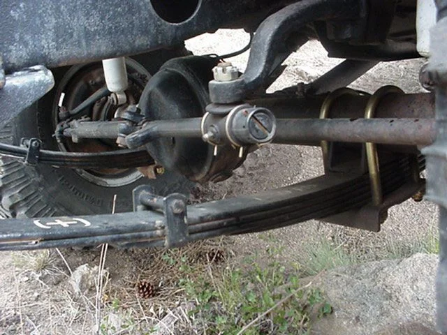

And a couple more
I just realized these show the steering pretty well while being flexed:

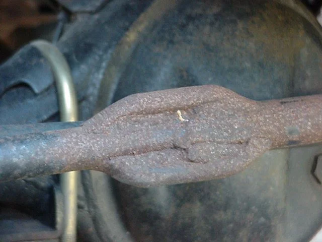

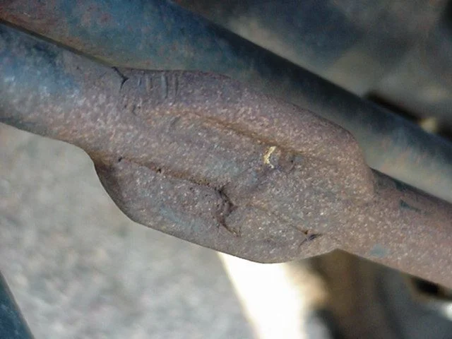

Relay Rod
Since this write-up I have gotten a few inquiries about the relay rod on this project.
A quick review: I kept the 40 knuckles on the housing, so I needed a way to tie in with the 60 series pitman arm.
What we did is mate the 40 relay rod to the 60 relay rod with some splints on the outside of the two arms. The splints were notched to accommodate the different diameters.
I contacted CDan about a rebuild kit for the pitman arm end of the relay rod and found Toyota has upgraded the end - you have to buy the entire relay rod for a 60 series.
Here are the pictures:

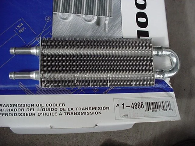

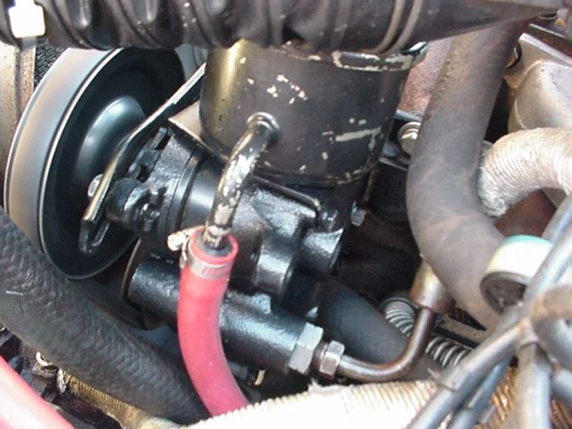

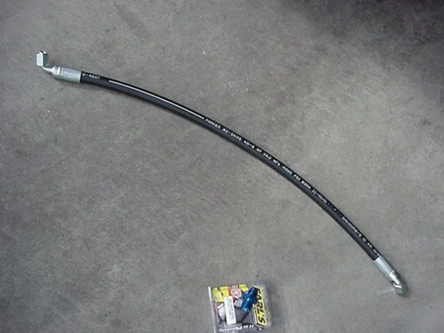

Well, I have been talking about adding a PS cooler to keep the pump from barfing when it gets hot.
I also wanted to replace the stock 60 series high pressure hose with one that could be routed correctly in the engine compartment.
So I got a spare PS pump to rebuild and sourced a cooler. Then when went to see about getting a new high pressure PS hose made, I found it difficult to source custom made hose with metric fittings. Thanks to some posts by Mace, I found some adapters to adapt from metric to #6 JIC. I got two of those (one for the box, one for the pump) and away we went.
I like the resulting set up much better. The high pressure line is no longer running near the EGR and exhaust manifold. Now the low pressure side runs to the far side of the radiator to a cooler.
We will see how this does next time I am aired down and running tight turns in the sand!

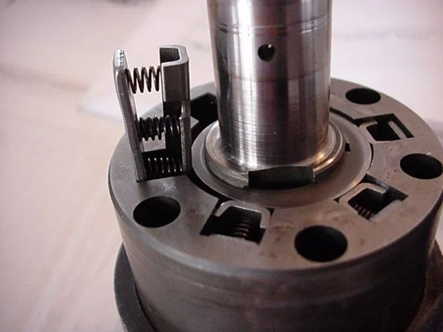

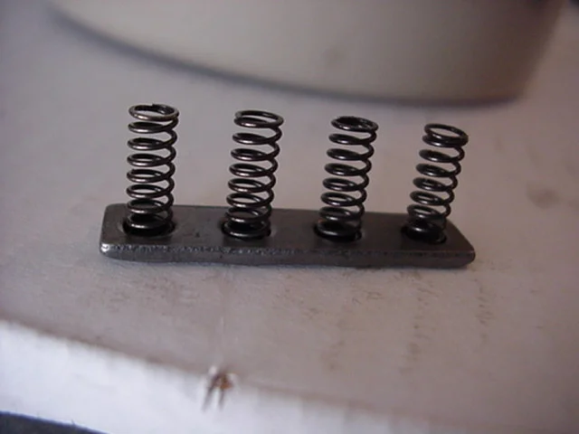

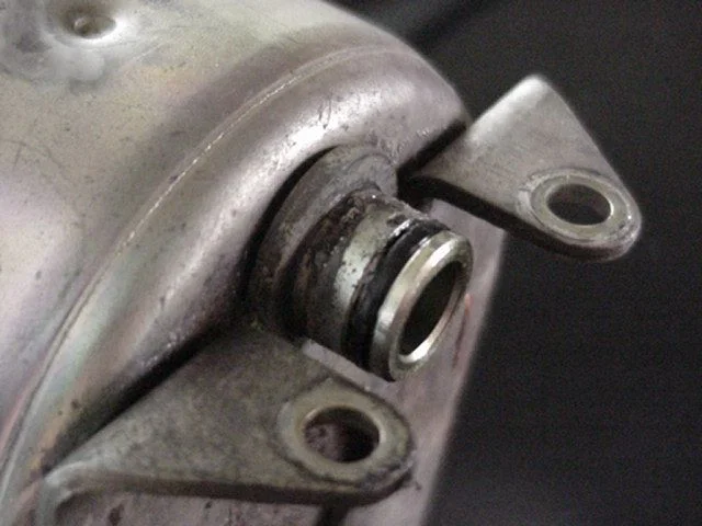

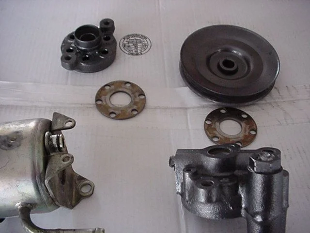

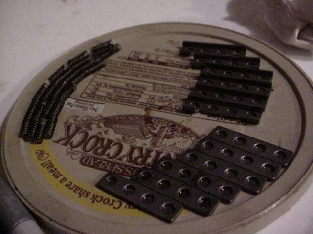

First I rebuilt the pump using the FSM - nothing too tricky.
Just watch things when you tear the pump down. You don't want to loose the springs that ride on the slippers!

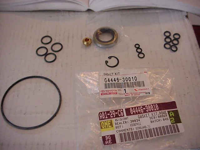

I cleaned everything and got a rebuild kit from CruiserDan and put the pump back together...

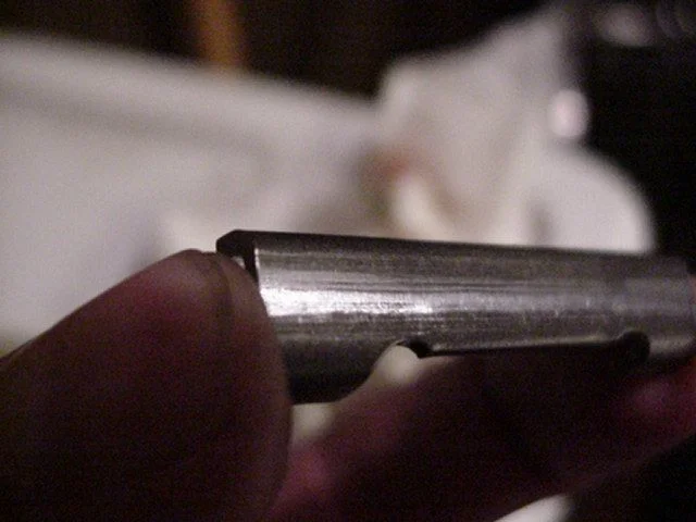

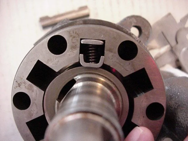

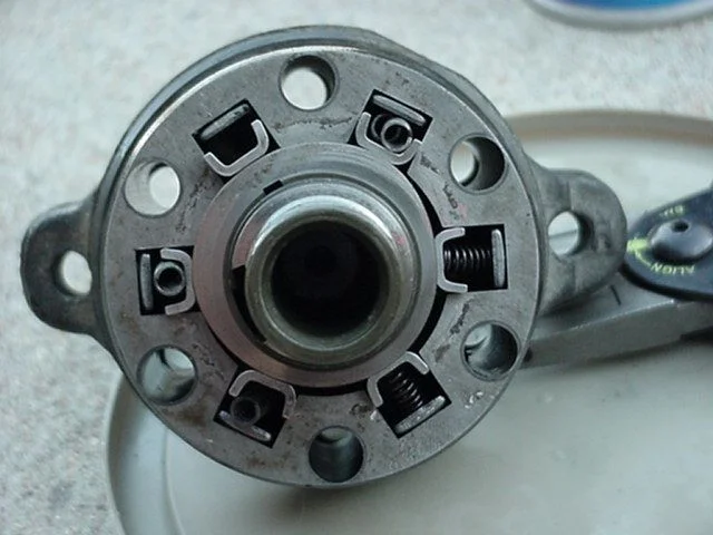

Reassembling the compressor portion of the pump takes some patience.
You will need to orient yourself to the rotating direction of the pump in order to correctly install the slippers

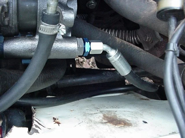

Here is the fittings used, the configuration of the high pressure hose to keep it as far away from engine heat, and the cooler I used.
On the new hose, I sourced a 90' fitting at the box and a 45' at the pump.

Here you can see the new pressure line routing vs. the old.
Also, take a look at the new PS pump cap that Toyota sells. You can no longer just get a replacement gasket for a leaky 60 series PS pump cap...

No, but I'd like to know what the cooler, fittings, lines, rebuild kit, etc. cost you. My 42's pump leaks a decent amount, and I've got a spare in a box that I'm sure needs to be rebuilt. Might as well add a cooler while I'm at it.
__________________
84 FJ60, locked and lifted and dismantled with Mercedes diesel
1982 BJ42 loud and slow daily driver on 33s
Horsetooth 4-Wheelers
polarweasel is offline   Reply With Quote
Old 03-05-08, 05:40 PM   #52
IH8MUD Lifer
PabloCruise's Avatar
Join Date: Jun 2004
Location: Northern Colorado
TLCA# 10713
Posts: 4,945
PS rebuild kit from CDan runs around $40. I think the new style cap is ~$12? (Honestly can't remember)
The cooler is a ~$40 NAPA piece...
