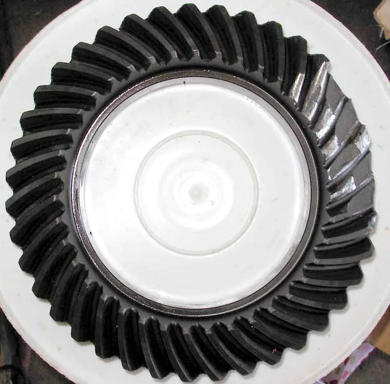

Quote:
Originally Posted by 88chevota View Post
I was thinking about putting in a FJ80 front in with an e-locker and selling the axles complete as a pair. The housings kinda go with the lockers. They are a little different than stock axles....I think? Maybe the hybrid could work though. we'll see. I have been thinking about it before you mentioned it.
I saw that you did it. how do you like it? I wonder if it will work with the full float housing?
Just say "NO" to mini truck ring and pinion in a Cruiser! 80 birfs and axles are really tough but the reverse rotation 8" R&P is a huge downgrade to what you already have! You can hybrid a 6x housing and 80 ends using 80 birfs and 6x inners but then you still are only the width of the 6x and you still need to deal with hi steer issues. The ONLY advantage of a Cruiser full floater in the rear over semi floater is the lack of c-clips. Unless of course you plan on hauling some weight.
Edit: What happens when you combine mini truck stuff on a Cruiser?
