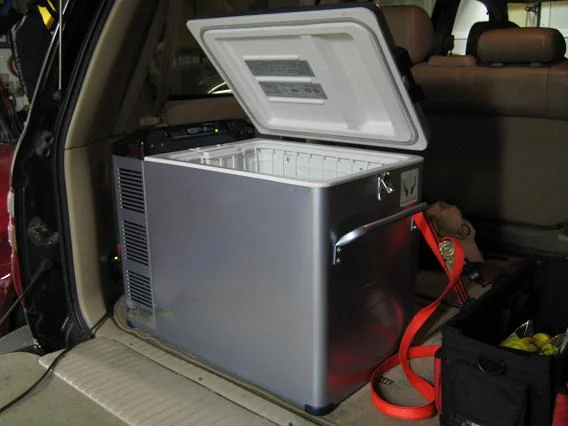

ARB Fridge would be cooler if it opened like this.
Any body done this?
Seems like you could just screw hinges on one side and a latch on the other an be all set.
It is essentially a traditional metal sided cooler.
I am usually all for drilling holes and modifying stuff........but.................... this is an awfully expensive thing to drill holes in

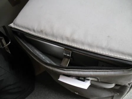

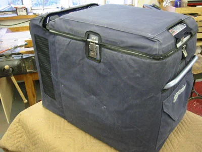

The Engel transit bag falls on its face in the latch area! Just about all of the Engel transit bag has this area totally stretched out or just plain messed up!

You can zipper yours shut though.
Of course that might be a pain as well.
Time to call Kurt.
Or get out the scissors.

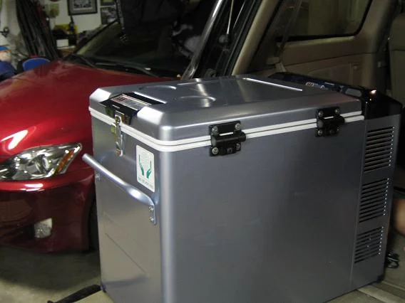

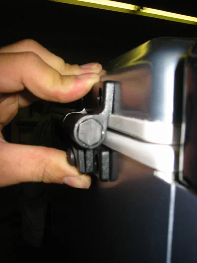

Ok, my ARB fridge is now even cooler.
The hinges have a tension adjusting screw so the lid will stay in whatever position you put it and they have just enough room to fit over the welting.
The latch is a spring compression one that holds the lid nice and snug.

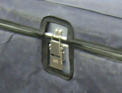

And I cut the transit bag around the new latch for clearance.
I like it.

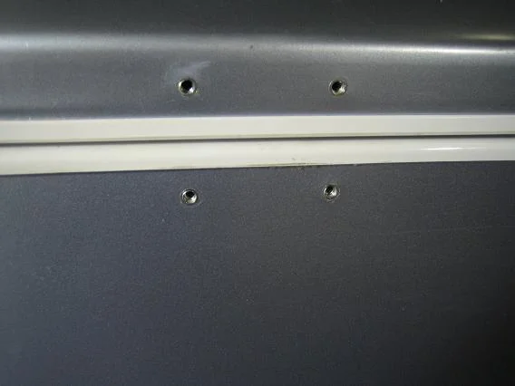

I assume you ran the bolts all the way through the side of the freezer and used a nut on the inside?
Did you re-sew the cover? Looks OE

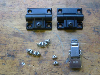

Thanks, glad you guys like it.
Mc-Master-Carr Parts
Friction Hinge 1791A48
Draw Latch 1794A43
6-20 X 3/8” self drilling screws 92364A146
1/4-14 X 3/4” self drilling screws 92364A275
Kurt, I decided to just use self drilling metal screws. If they don’t work I will dismantle the fridge and put nuts back there or just use nut-certs. They seem to hold very tight and I think they will work quite well.
I cut the bag and sewed binding on like the other latch opening has. I am not thrilled with the way that turned out, it’s a real bitch to stuff that bag through the sewing machine. But, it looks good from a distance.
Yooper, I thought it would be better hinged the other way as well. However, if you look at the way the D pillar angles in you can see that there is not enough room for the lid to open unless it is where it is. As it sits, the lid opens right into the window and clears everything perfectly. It’s a bit further of a reach, but it fits best that way and makes it a bit easier to get at from the back seat. Also, it keeps things from getting stuffed against the cooling fins like would happen if they faced the other way. Everything is a compromise I guess. Amy likes it, so that's all that matters.
