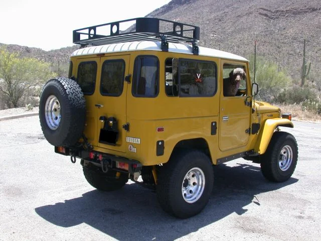

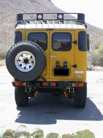

do you have any pictures of the roof rack? i'd need two of those sheets, is the 16ga big enough for you? like can you walk on the stuff without it bending? if i went expanded i'd get aluminum, flattened, a heavier guage with the openings around 1.5" wide so i could easily get bungee cords or tie downs in the openings. maybe i'll take a few pictures of the roof rack, take some measurements and post some pictures.

I haven't built it yet, I just picked up the sheet since I was there. My plan is to bend it up out of 16 gauge 1" round tubing and add crossbars as needed. The idea of larger pattern diamonds for tie down pts is a good one. My neighbor converted his jet ski trailer to a quad hauler by adding the same expanded metal, he's 220lbs and can walk on it. I'll grab some pics the next time he is out.
I'm going to run steel since for a given geometry it's stiffer, easier to weld and a bunch cheaper. I had serious sticker shock pricing out some aluminum rectangular tubing. I have access to an AC tig machine now, but it would take forever....
Edit: Now that I think about it, I believe we used 13 Ga on the trailer and that's what I bought too. I'll probably use the 13 gauge for the cargo barrier and run 16 on the roof rack.

Quote:
Originally Posted by metalonmetal
here are some pictures, the rack has an inside dimension of 58" x 80.5"
I had the same basic floor in my Conn-Fer rack and gave alot of thought to what I would do since the plywood sheet was, well lets say that after 10 years in the desert sun it had to go. This is what I did. I'm very happy with it and it is much stronger. If you would like more detailed photos, I can post them. The tubing I used was heaver wall than standard and I have not had anything up there small enough to fall through the spacing

go for it, i'd love to see some more pictures. i think it's a good option, and whatever i'm putting up there will most likely be in my canvas bags or boxes, so the spacing wouldn't be an issue. i don't know anything about the conferr racks, are they aluminum or steel?
They are steel. More photos tomorrow
