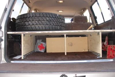

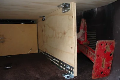

I made this today, took about 5 hours including 2 runs to ACE for the fasteners and stuff.
3/4 plywood, galv L brkt and some storage bins that slide in.
Cost about $100.
It sits about 1/2" below the top of the tailgate, I still have enough height for my future ARB fridge to sit on top. When I finish my rear bumper the tire will move outside. The ports right behind the seat are to let my subs pound(thats what the box is underneath the deck).
I decided against trying to make an actual drawer setup for 2 reasons, this was much easier and much lighter.
Some pics

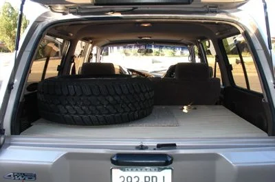

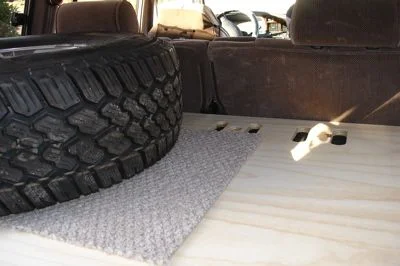

Couple more pics

How is your tire mounted and held down? That could be really dangerous in a panic stop or accident.

looks good buddy, and get a strap at least on that tire.

I went out later after taking those pics and solved that problem. I have a D-ring bolted to the deck and a metal plate, then a strap thru the rim to keep it still. Got it covered!
It would be a lot easier to make the 2nd one thats for sure Kevin. My brain wasn't on all cylinders when I cut the top deck. I made it to fit nearly perfect once inside. Only problem was then I couldn't get it in the truck I trimmed about 2" off both sides then I could angle it in.
I took it on trip today, about 200 miles round trip. Alittle bit of wheeling, all with the dog and her blanket on the deck next to the tire. Those storage boxes underneath have less than 1/4" clearance but when I hit some good bumps the contents inside jumped a little. Otherwise, all good.

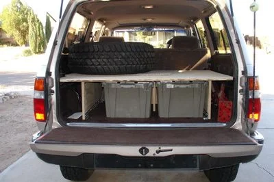

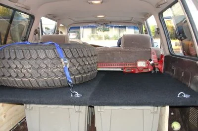

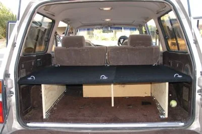

Storage solution - finished!
I spent a week looking at my new deck and decided it need something else. So, for another $30 I added 6 tie down points and carpet.
Pics

what's the little high lift for?

I haven't yet figured that out, my superior skills as a driver have prevented me from ever using it

Quick rundown on the material list
1 sheet 4'x8' 3/4" plywood. The main deck is 55" wide x 42" deep with the rear corners cut off to fit with the rear pillar. The uprights are 2ea 13"x36" and 1ea 12"x13" support for in the middle.
2ea L bracket 39" long. I used the 4 tie down hook points to mount these to the floor. I slit the carpet and layed the short side of the L bracket under the carpet. I had to get longer bolts and extra washers(for spacers under the bracket) to mount these to the floor.
I used 1/4" x 1" bolts and 1/4" x 5/16" tee nuts to secure the uprights to the L bracket. and 1/2" wood screws with some roofing V brackets to secure the deck to the uprights then some 1-1/2" thin wood screws thru the deck into the uprights.
6ea 1/4" u-bolts with 1-1/4" fender washers and teflon locknuts.
2 rolls of automotive repair carpet and some 3M multi-purpose adhesive spray and stapled underneath the edges.
The storage boxes I ordered from C&H Distributors. My work has an acct with them so I got them at a discount. They are HDPE with stainless hinges.
I wheeled the holy crap out of it a couple days ago and everything is holding together well. I did however pretty much trash that wind deflector on the back of the rig and almost tore off my firestix antenna. Seriously tight trail with a lot of LOW hanging trees

bad answer. in all seriousness, a 48" high lift is useless in most situations. At least on the trail. It may be tall enough on a dirt road, but that's about it.

I understand what your saying John, but for me, at the extreme end I run 3.5 rated trails and I'm not scared to take bypasses or stack rocks. In 3+ years of carrying that jack I have never needed it. If I ever get into a situation where I need to break it out, I feel confident I can make it work. One way or another.
