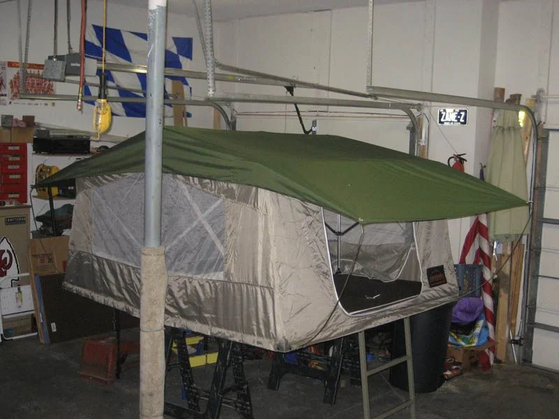

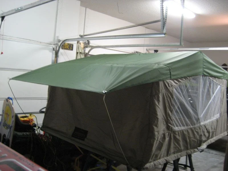

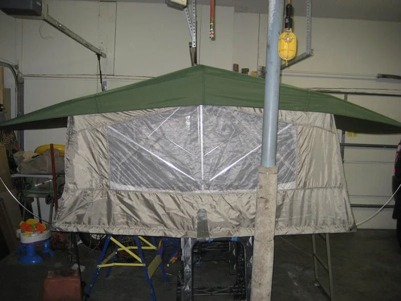

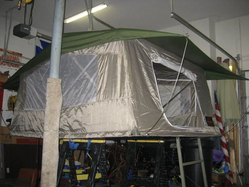

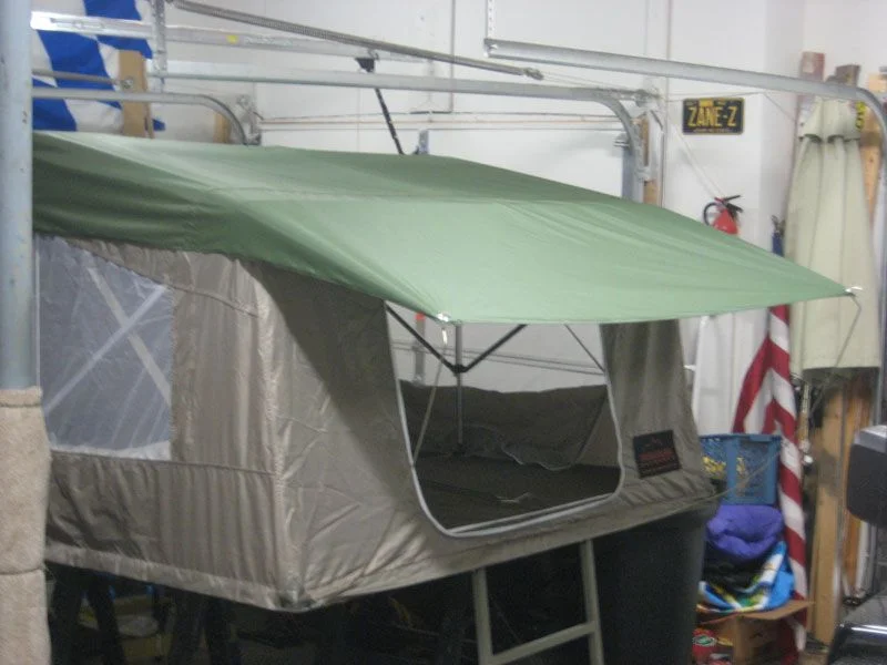

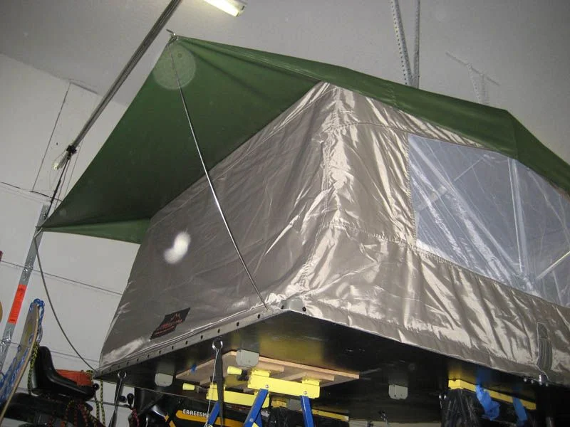

Ok, we all know by now that the rain fly on the mombasa tents are not worth much of anything. As others have stated many times over this tent is a great buy and of really good quality other than the rain fly and the ladder.
So I have decided to take on the project of making my own updated rain fly. My father in law is in the textile industry and has some really nice industrial sewing machines so I figured I would try and see if I can find any Betsy Ross is in me.
I have ordered some Poly coated Nylon Oxford samples from Seattle Fabric to determine the appropriate weight and color to go with. Once I have decided I will post up what exactly I when with. So I have taken a picture found on MUD of the Mombasa and have mocked up my first draft design. the dotted/dashed lines are that of the original tent. The rest is penciled in over the picture. I have taken my ideas from several different tents, but mostly used the Hannibal tents rainfly as my lead.
I will be making my template out of cardboard before I start cutting so that I know exactly the patterns I will need to cut for each section.
I have received a set of 8 steel spring poles for the project that will allow the rain fly to stand out on its own over the sides as well as the two large windows.
I will keep this post updated as my project comes along.

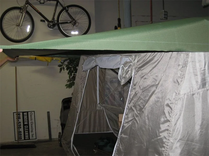

Here is my solution. I bought the new model.

Being the one who lifted both of them, the weight difference is nada.
Maybe 5 - 10 lbs. I actually got the Expedition one up on my rig by myself with only one little scratch to the paint...(and a hernia).
However, the pack height is about 4" taller which I don't like but I plan on putting a different rack up there and the smaller length gives me 20 extra inches.
There are aspects about the old one I like better, one being the excessive room inside. Very cool, but a better fly would have been nice.
In my opinion, they are both very functional platforms. You don't have to drop $1800 to sleep on top of your vehicle in comfort.

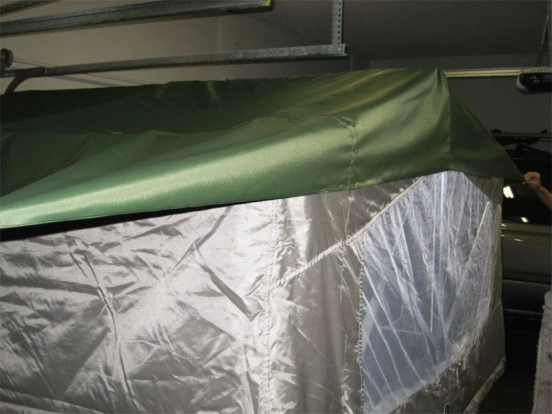

No I'm building the fly separate from the tent. If you look at the attached image you will get the idea of what my rain fly will look like. The only exception is that my side window awnings will be part of the rainfly not part of the tent.

ideally you'd want some air space between the fly and the main tent, I would think, no?
Agree with you and have searched but have not seen any pictures of how they do this on other tents. Anyone have any pictures of there roof top tent without the rain fly on it and how the exterior bars for the fly are attached?
Zane
I agree, and have an idea on how to do that, but I'm not sure it will fold up and deploy like that yet, which is my goal, I want as little messing around as possible. With my design, there will be a few poles to quickly put up, but that will be done from the ground without any climbing on the truck.

realistically, though, the air gap thing was much more critical for rain before they had real waterproof fabric, so maybe not so much to worry about nowadays for rain. But you'd still want a gap for sun and heat issues, I would think.

So I have scaled back my rain fly to mirror that of the New expedition RTT rain fly and see how that works and if needed I will add the sides to the tent as well. I have sewed up the meat of the rain fly and did a test fit this morning. Pictures are without the spring poles in place and my wife and I are simply holding up the ends to show what is will look like. Once all four spring poles are in it should be nice and tight. Next step is to place some webbing with clips to attach the rain fly to the tent to keep it from blowing away in heavy winds as well as provide the ability to tighten up the rain fly if needed.
Please see pictures.

very nice !
(my, my, we're quite the little seamstress aren't we....? )
I think you'll want the side pieces if you're doing this for rain, no? These windows would be too likely to become sources of ingress... Isn't that the whole point of a serious rain fly? (otherwise one could just put waterproof sealer on the OEM roof section and be done?)
Tell us more about the poles and how they'll fit, please.

Thanks for breaking ground on this, I would think with a small overhang over the ladder you would be all set.
Looks great man, where did you source the spring poles?

As of last night I have completed the rain fly other than the straps to hold it in place on the sides of the fly. That is the easiest part of the build. It has turned out really well and I think it will do a much better job than the old rain fly that the Moombassa came with. For those who have asked, I hope to be able to give you all more information on the source of the spring poles shortly.
Please see updated pictures.

a few more:

That looks awesome. Great job!

Yeah, no kidding man! Looks great!

Where did you source the fabric from? That came out great!
