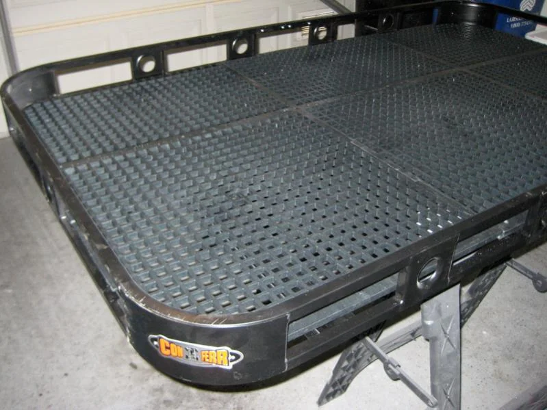

Here is my second, larger ConFer rack. For this one I used chicken coop flooring from FarmTek for the floor:

egg xactly what I did as well. Won't be seeing any rust issues on the flooring any time soon. lol.
First used heavy duty zip ties to secure the flooring to the rack but that only lasted about a year in my super hot during summer weather....the zip ties got brittled... I resecured the floor with a bag or 2 of home depot hose clamps. working out great now.
These interlock so I just used large fender washers and bolts on the four corners. Its not going anywhere.
