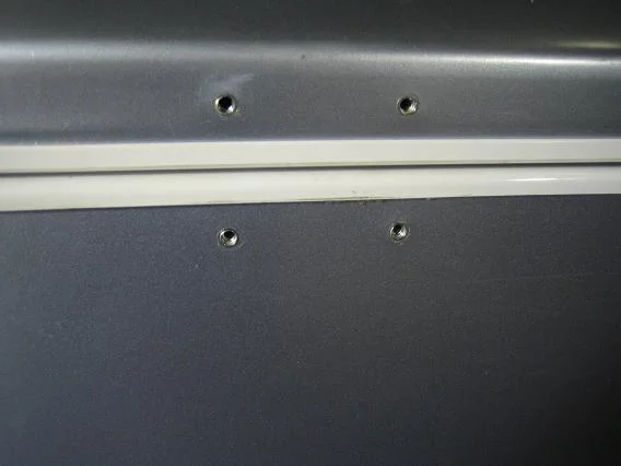

I did it quite similar to his except I used nut zerts for the hinge screws instead of just going into the case. I ended up using the old hinge screws and put some washers under them for strength, they also don't look too bad, I'd rather have the strength personally.
Attachment 83197
Are the nut zerts easy to install, special tools needed? Do you need to dismantle the casing to get those in?
Another cleanly done mod.

You don't have to dismantle anything. Just be careful drilling the holes. It's mostly insulation behind the metal.
You do need a special to install the nutzerts. You can probably get one from mcmaster for pretty cheap though.
I think about this mod about every other time I open my fridge and I really like it when I have the baby in one hand and can get something without the lid falling off and the lid stays open

Great to hear it is still working. I on the other hand never think about this mod, that is just the way I like it
On a side/update note, hinge setup is working great and I have since had to dismantle the entire fridge (leaky condenser, all fixed, great customer service) Even if you slip disastrously and drill right through the fridge, you wont hurt anything.
The body is just foam insulation all the way to the inner plastic of the cooler, then there is the 1/4" gap, then the metal cooling tube surround. To damage the fridge you would somehow have to drill through the outer skin, through the foam, through the inner plastic skin, past the gap and into the metal cooling tube housing, and even then you would have to be lucky enough to actually hit one of the few coolant tubes.

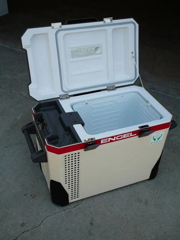

Anyone do this to an Engel? I don't see why you couldn't although the lip profile looks to be different.
The hard parts should be the same between the two, and the part/construction diagrams between the two are the same. There wont be anything in the way as long as the hinge fits over the Engel edge trim.

Just got word from a "genuine" Engel install that the fit is the same as with the ARB.
